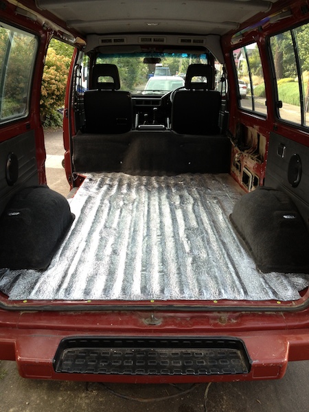

I started by ripping out the carpet and adding insulation and a thin plywood floor. I painted the plywood with truck bed liner and it's held up relatively well. Figured I could get some thin vinyl flooring to cover it if it doesn't hold up.

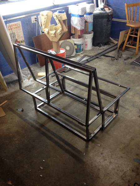

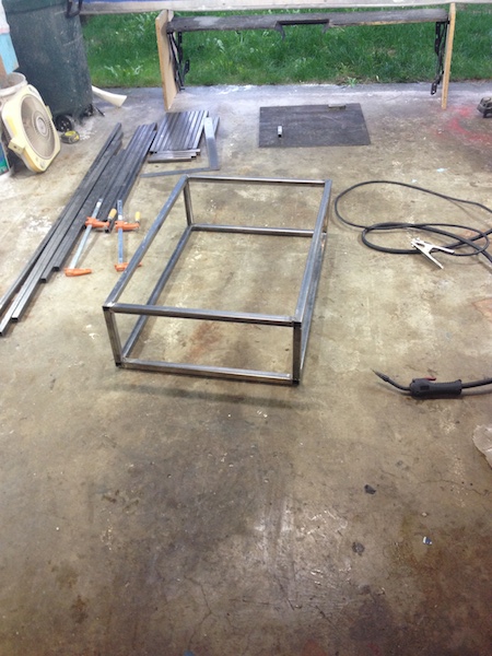

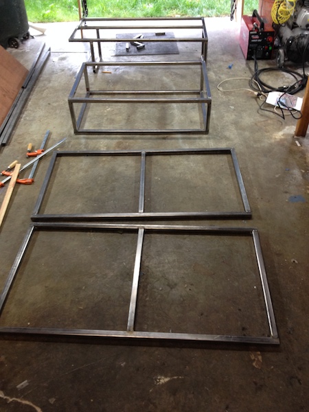

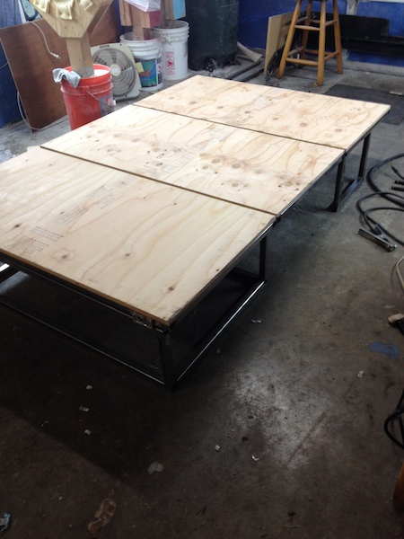

I spent about $100 on 1' steel square tubing and $250 for 110v welder. I had the steel yard do all the cuts so they were even and about 40 of them in total. Since everything was being welded together with corner joint welds, it saved me a ton of time not having to cut each piece.
What's nice about this design is that it's pretty basic and modular. You can piece it together in sets before attaching everything.

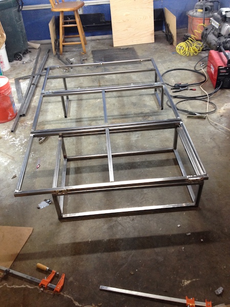

Here the frame is completed and all 3 parts are welded together via hinges.
Here's how the frame folds into place. Just lift in the middle and go from bed to bench in no time.

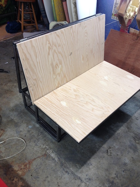

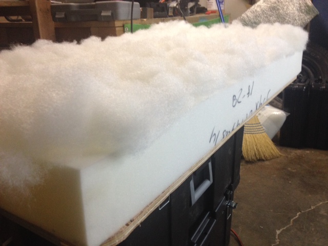

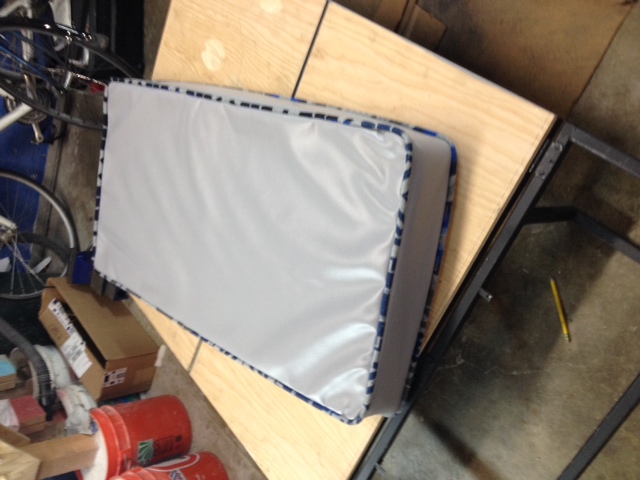

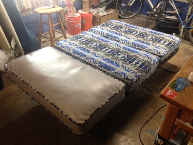

I bought some 4" foam that matched the dims of the 3 panels. We decided to use the wool for the 2 back piece and vinyl for the bottom since the dog likes to sit up there. I attached the foam to the wood and added some batting to round it out and add cushion. Lastly, just pulled the fabric over the foam and wood and stapled in. Each panel is attached to the frame with screws.
photo 2.JPG (92.68 KiB) Viewed 9207 times
photo 3.JPG (102.84 KiB) Viewed 9207 times
All laid out, it rests just over 6' long.

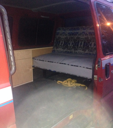

And the final view in the van. Sorry it's dark here now so I'll try to get a few more pics up shortly of the final project.
