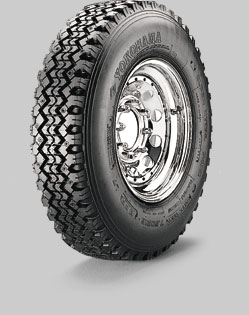

Might be answering my own question but after searching what else is out there, I came across the following tires:
Yokohama Y7425S with size 7.00R15 which makes them 29.8" tall by 7.7" wide compared to a 235/75R15 at 29.1" tall by 9.1" wide. They weigh 36lbs and go for about $115 US (a bit pricey). I haven't found out yet if they can be bought here in Canada but it's still a short trip to the States if needed. They look like a really good offroad/winter candidate...
Is there pros/cons with this type of tires?
- Y742S.jpg (19.34 KiB) Viewed 5583 times
