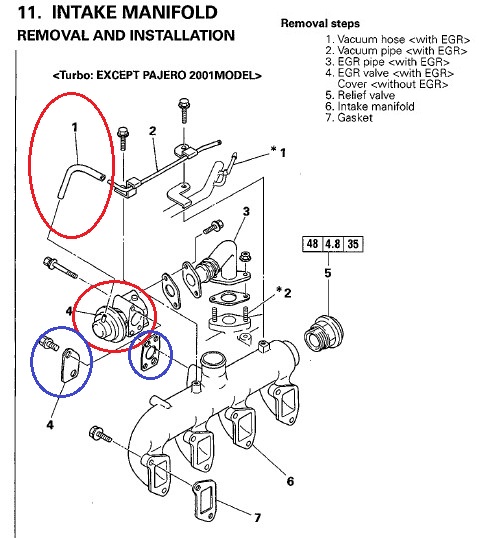

Sounds like the EGR bypass valve. Under load it pops farts and bogs down yes?
The quick parking lot fix is to disconnect and plug the vacuum hose that actuates the EGR with a small bolt/screw. There is a blanking plate that you can install between the intake and the valve that effectively isolates the EGR.
The red outlines the valve and vacuum line to remove and block.
The blue outlines the gasket and optional blanking plate......funny that Mitsubishi offers a way to defeat the EGR right from the factory! You can either buy the plate from ebay or make one out of sheet metal yourself.
