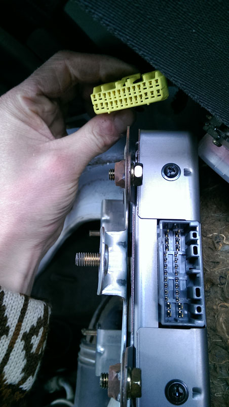

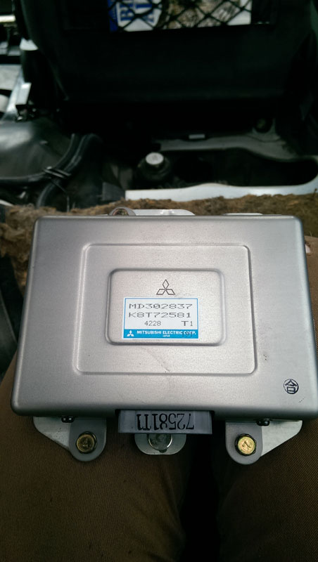

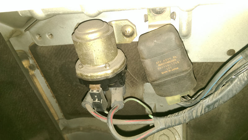

Please see the following photographs for reference. Can anyone identify this system?
ECU
ECU
Harness and ECU
Harness and ECU
Relays
Relays
I am considering bypassing this system using a manual switch to operate the relay just to make things easier, but I thought I would take a stab at the diagnosis regardless to see what can be done.

The actual voltage devliered to the glow plugs is not a full 12volts. Glow plugs are rated at 6V and 11V for the Mitsu deli's.
Take a look at your glows the next time you pull em and look for an 11V on the hex head. So 10.5v is normal.....besides the glow system does have a resistor in the system that steps the voltage down a tad. Normal dude!...just weird.
The ohm's are just one check you can do to a glow plug. I live just up the hill from you in Varsity and I think its about time you met a few other Deli owners.
check your pm for a contact number. Happy to help!
