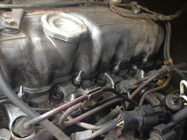

These are the tops of the glow plugs (I've already removed the wiring and plate (the bus bar) on this photo).
Here's the photo with the plate and wiring:

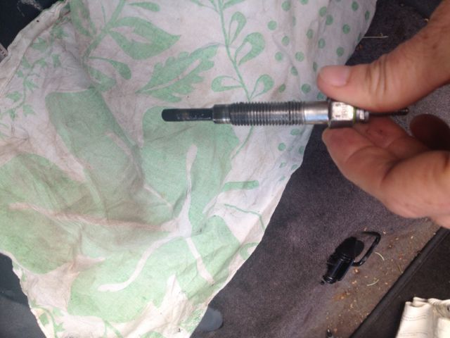

The first glow plug I pulled out. There's some oil on it which bothers me... is this normal? (it doesn't seem like it should be) Does it suggest an oil pressure problem?

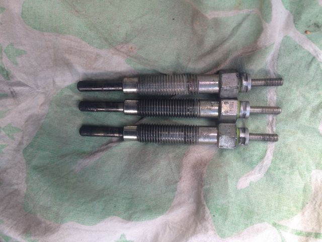

Here are three of the four after cleaning with a rag (I replaced the first one, then realized I should compare all four):
After cleaning and replacing all the plugs, I tested the connections again.
On the battery: 12.38 V
On each plug: 12.36-12.37 V
Between each plug and the bus bar, with the key turned on: 12.36V
And it fired right up on the first try. So I guess the plugs between fouled with soot/oil was the problem. If anyone wants to comment on this that would be helpful.
