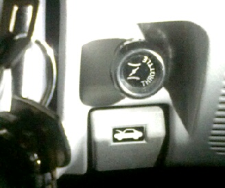

The Gen I L400 2.8TD uses a mechanical IP and is usually equipped with a manual throttle control for setting idle speed.
The Gen II L400 2.8TD uses an electronic IP so your idea might be possible on that version. There are only a handful of Gen II owners who visit this forum, perhaps one of them can confirm if the Gen II has a manual throttle control or not.

My L400, a 1995 Royal Exceed, does not have this.
Any idea where to get it?

My '96 Jasper had the throttle control, but my '96 Exceed did not...

Flibble: If you want the manual cable the best local sources for used units would be Commbs, Rising Sun Imports and maybe Amazing Auto but the previous 2 have an extensive collection of Deli's on hand that are used for spareparts.
The other avenue is to poke around the EBAY.CO.UK website and find an England based auto wrecker who will ship the used part to Canada.
I have used Scottland Yard Spares with great success.

I have the series 1 L400 royal exceed. Ive found where the switch should be, just a plastic plug sitting there. Ill ask around for a switch, anyway I could get an aftermarket fast idle switch to work? Ive found plenty for diesel pickups....not sure if they would work though.

Yeah, I have the plastic plug on my Royal as well.
I wonder if they did not come with them?

I have a 94 Super exceed and it does not have the switch either
