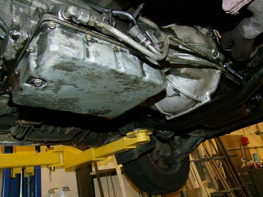

So when I punched 'Mitsubishi vanwagon transmission pan' into google I got these pics of a Mass. Registered VanWagon. He was nice enough to have a decent list of repairs and pics of his progress. The vanwagon's auto tranny is supported near the tailshaft with a tranny support which is well away from the tranny pan. No need to pull the mounts for your pan/gasket work. Can't guarantee if you have skid plates in the way or not but you should have a full set of wrenches and sockets for this job regardless. Bring a good scraper to clean the gasket surfaces and a scotch brite pad to clear-off any sticky bits. Why are you having to putter with this in the mud? Did something fail?
From what I can gather in the attached pic; you appear to require a 10mm socket to pull the pan bolts and a 13 or 14mm socket or wrench to pull the drain plug..that is if you have one like this guy does.

Thanks - appreciate the reply. The pan has a leak as it appears to have scraped a curb or road debris. Yesterday I drove over and lay in the mud on some plastic sheeting. It appears the leak is slow enough I could refill it and get home. Takes a drop about a minute to form. That means I will then pull the pan and lose several fresh quarts. So, I guess that will be my baseline fresh on the tranny I would have done anyhow. The dealer says it requires a special Mitsubishi tranny fluid - true? The tag on the driver's side says "03-721" in the Model NO square. If this is false and I can use Dex II or somthing, it would be nice to know as I paid $11/qt for that stuff and have gallons of Dex II around my garage.
So that eliminates pulling the pan away from home. Laying there, the dipstick tube is on the driver's side away from the pictures and it angles up and forward into the engine bay. So I was unsure if I could have gotten the pan out of there with the Van on the ground. At home I can get it up on jackstands for better clearance.
