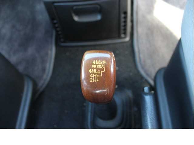

I am having troubles with my super select system. I can shift into 2H, 4H and 4HLc but cannot shift into 4LLc. I have tried reversing/driving forward in a straight line, as well as pushing forward hard to shift it.
Is there a secret to shifting to 4LLc? I noticed the diagram on the shifter doesn't continue the line to 4LLc. Am I missing something? Do I have to twist it or tap it nicely?

The L400 automatic tranny needs to be in Park or Neutral before it will allow the transfercase lever into 4Lo. It can't be shifted into 4Lo while the transmission is in any other position.
If its difficult to shift into 4Lo try pushing the transfer case lever down while shifting left and then hard to the right. this will usually loosen the linkage which can get stiff from lack of use.
I tried this with my own L400 while I typed this up just to confirm operation and my Japanese Manual has pics which show the same info.

Is it actually possible to shift the transfer case lever past 4HLc? I thought you just used to gear shift to drop down into Low while you're are in 4HLc to achieve 4Llc.

The transmission does not allow the driver to shift in and out of 4Hi Lock and 4Lo Lock unless the vehicle is stopped. Trying to force this gear shift while moving usually breaks things in short order.
I went back and checked the shifter handle on my Transfer Case and a few others like this one online. You must PUSH down in order to engage 4Lo. This is a safety feature that prevents the shifter from being dropped into low gear by accident.

Aaa part of the diagram on my handle had faded off. Always thought 4Lo was geared to high haha

Big-Bird wrote:The transmission does not allow the driver to shift in and out of 4Hi Lock and 4Lo Lock unless the vehicle is stopped. Trying to force this gear shift while moving usually breaks things in short order.
Excellent. Thank you!! This will solve my problem I'm sure of it.
By the way, what model is your Delica? That's a snazzy looking shifter handle :-)
