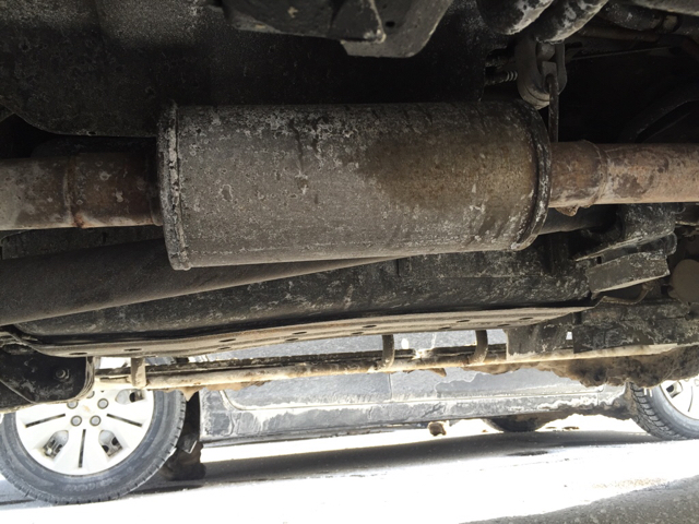

The OE system finally gave in to Alberta road salt and split down the tube seams in more than one place. Diesel exhaust water is so darn corrosive! Dam.
So now its time to get an upgrade. Going for the 2.5" pipes but the muffler choices have me stumped. I want good flow of exhaust but don't want the drone that makes your ears ring for hours after a drive.
What have other Spacegear owners done?

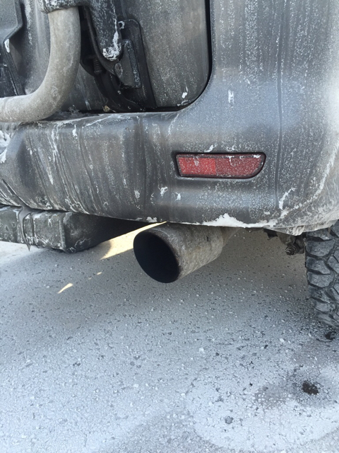

Rear facing tail pipe is what I want. Having a side dump just gets in the way when I'm on the trails and it can also upset fellow drivers as a side dump would put diesel exhaust into the face(s) of drivers beside you. Not very pleasant to get a face full of sooty ash.

Basically, if you want quiet, find an OE system. I picked up a takeoff from a Chevy truck with a 6.2 that I am going to adapt to fit. It's 3+ inches, so it will flow, but it will also be quiet, as it is OEM.
With the turbo, you can't really oversize the exhaust. Whatever gets it out the back of the van with the least resistance. I am going for a side dump exhaust, but I am going to turn it down so it's not blasting directly sideways into people/cars.

I'll try and remember to snap a pic of mine too, 2.5" through a small magnaflow straight through baffle, out the back with a 3" tip. I like it. On the highway the engine drowns out any exhaust noise.

The restriction at the stock Turbo is still 2" so I am looking at the 2" and 2.5" system. The stock bends could be flattened out a little to reduce restrictions and then obvioulsy dump the stock 4-baffle muffler and get a nice stainless unit with a single baffle. Cap off the system with chrome down spout to direct exhaust to the ground so my trailer doesn't get sprayed with soot.
