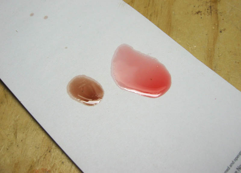

What is the colour of the transmission fluid? Bright red is good, black is bad. Put a drop on a piece of white paper. Also, drain the tranny, remove the pan and remove the inner filter and replace and check if there are bits of metal in the filter. Mine started slipping, but it was because of a small hole in the transmission cooler located at the front corner on the drivers side. Flushed it, topped it up and replaced the cooler and it was all good.
