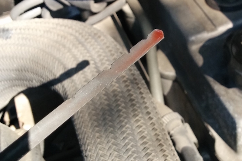

So I measured the level of the ATF after a 10 minute warmup, 10 minute drive and 5 minute idle (engine was at working temp halfway the drive, outside temp around 12C). Looks I might be running short on ATF? Or is this ok for such a short drive?

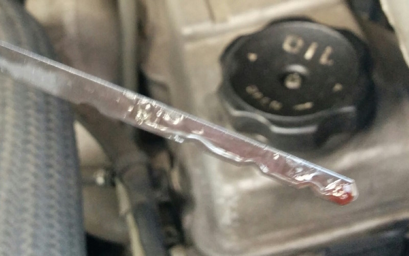

And this after another 20 minute drive.

Sorry, tapatalk didn't add the picture, so here it goes. ATF levels look good to me. Talked to a local shop in Whistler and they suggested something around the gas pedal sensor - that it's giving the transmission wrong information about the load, gas pedal position etc.

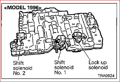

According to the application charts the 1994-1996 L400 uses Tranny Model # V4AW3-7 (plus some 2 or 3 letter ID Tag) in both the V6 (gasser) and 4M40 (Turbo Diesel) models.
This tranmission has an oil temp sensor on the side of the valve body housing. If it misbehaves it can put your tranny into a false SAFE MODE and will change how the tranny shifts. This operates an indicator light on the dash when the heat gets too high. It may not light when the sensor isn't reading properly.
There are a few solenoids on the side of the valve body (sorry bud these are inside the transission oil pan area). There are some differences in gear ratios and speedo gear ratios but thats not important here.
If you wanna know the ID tags: (UI/UJ/UIL/UJL/LI/MG/MGL/ML) and each one is slightly different internally
The 10V you read is probably due to the way its wired through the tranny control box inside the dash. FYI the tranny control box located on the floor behind the plastic divider at your feet.
The control box is probably getting 12volts at the input side and then it sends a lower voltage to the sensor. I find using paper clips useful in the hard to reach areas such as the temp sensors. The paperclip wire can be inserted inbetween the silicone seal and the plastic jacketed wire. Just ensure the paperclip tips are only long enough to give you a multimeter contact point. If you give the wire too much of a 'tail' they might touch/ground and roast a circuit in the tranny brain.
If I had the wiring schematics I could probably tell you what the ohm readings are supposed to be but I can't find the file....used to have the master electrical manual all in PDF. Lost the stupid memory stick!
Have you checked your overdrive switch on the end of the shifter arm? They do have a common internal break point but when they break it usually prevents OD from activiating without holding the switch down. Does your work properly?
