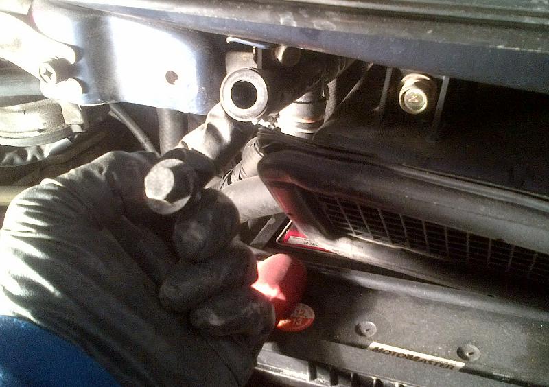

Remove the intercooler unit and set it aside. Drain and capture the coolant at the butterfly valve located on lower rad tank (drivers side). The valve should be turned 1 to 1.5 turns, any more than that and the plug pops out and coolant sprays everywhere. Also remove the rad cap and the Air-Plug(in my hand) located beside the fresh air intake vent for your heater/AC system

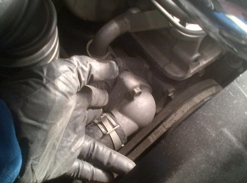

Next remove the 2 bolts that hold the thermostat housing. There is no need to loosen the rad-hose clamp as the housing and hose can be moved aside easily. There will be a mess soon so get the catch basin positioned for the next part!

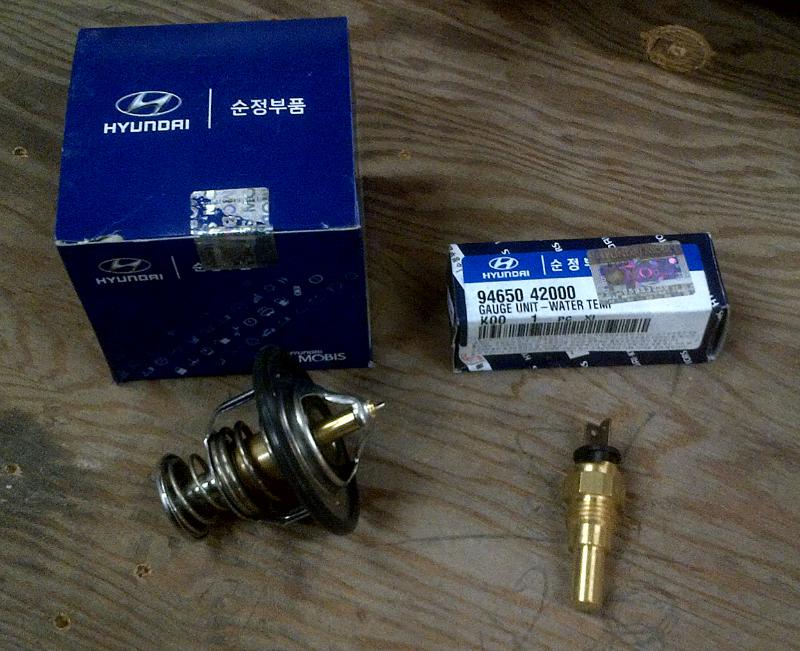

Once the cover is off you will see the nose of the thermostat sticking out. It will need some gentle prying with a screwdriver to get it free....here's the messy part folks.
Install the new thermostat with the springs in first. The thermostat doesn't care what clock-position its in but I do prefer to have nose laying horizontally. Next bolt up the housing....now if all you needed is a new thermostat then button everything back up including the intercooler.....DON'T install the Air Plug yet!!!!!

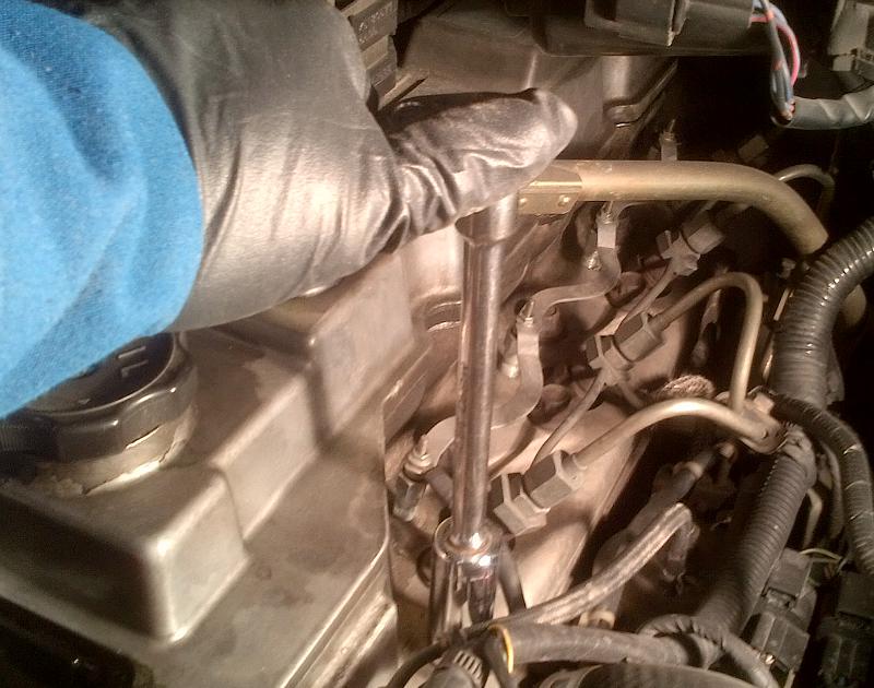

The probe is located next to where the upper radiator hose attaches to the intake manifold.
The probe has 2 contacts and the power connection does have a release clip.
Once the connection has been removed you will need a deep 14mm socket to remove the old plug and to install the new one(the deep socket prevents damage to the spade connections)
