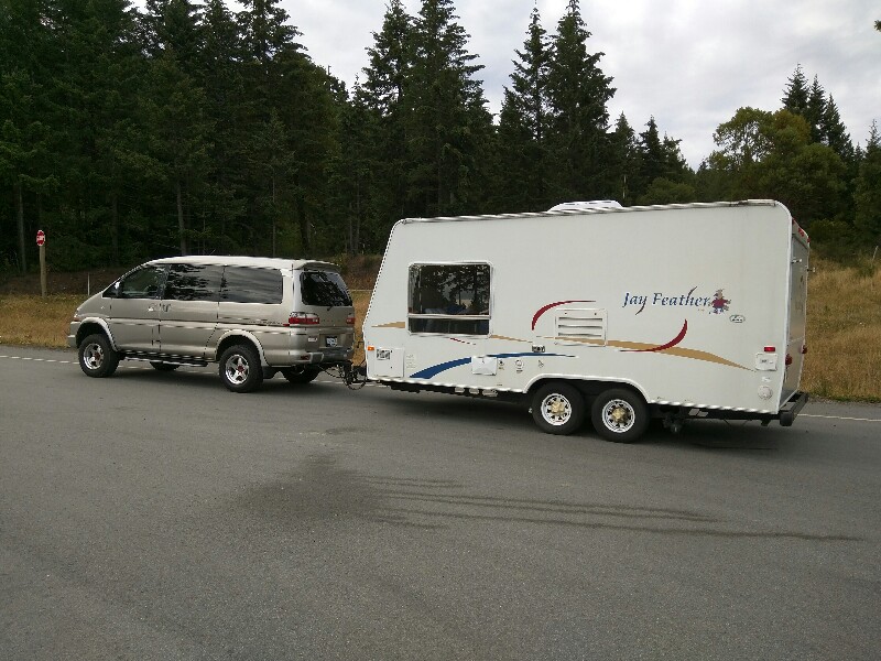

I've asked similar questions many times but always received vague answers with many 'shoulds' and 'coulds' in them. Finally bought a L400 V6 gasser LWB and hooked up our 4000lbs 19 foot travel trailer. Other than a 80kph top speed up steep hills the deli towed brilliantly last week over a 300km stretch. Much more stable than my old Land Rover Discovery, even with five people and a full load of gear in the van. Gas mileage was almost twice as good as well!
I'm running a two inch lift. For myself an equalizer bar is mandatory or the rear sags a couple of inches too much.
Not precisely sure how the diesel SWB would compare but I don't think you would have a problem. Bought my hitch from Coombs Country Auto. Believe they're made in Vancouver by E&H Hitch. When I called I was told the hitch is rated for 4000lbs, more if the drive train can pull the weight.
