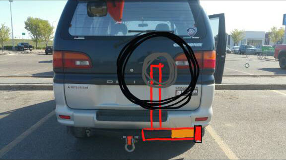

I've got a simple plan for those of us with a trailer hitch in the rear. Just bumping this so I can find it on taptalk and post a picture

Excuse the poor drawings, done quickly with a stylus on my phone. The tire will sit as low as possible, it looks high in the drawing, and is blocking my reverse light and brake light, it will need to be centred.

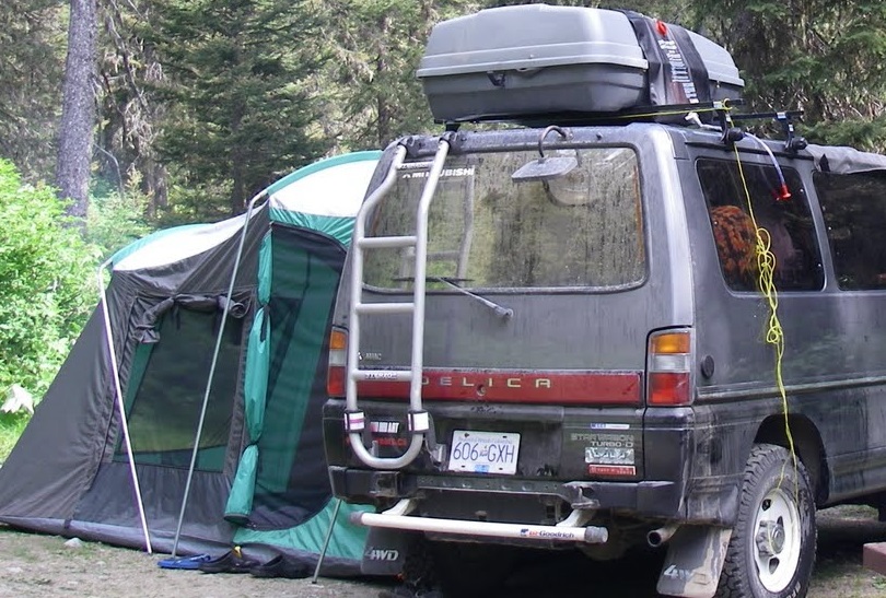

Could also be bolted to the front bars, seen this a couple of times, but this seem to awkward of a location.Big-Bird wrote:The plates are the most elegant option and likley the best choice...in fact I run 30's and will probably do this as well. Will likely use stainless plates and drill holes to size. Don't want a loose rack as it will only wiggle and wear out the holes over time. Been there with a SWAY BAR disconnect kit on my previous 4x4. The lock pins in the kit had just enough roof to slip in when new...had oval holes in 5-6 months. What a waste.
Less elegant but cheap!...throw it in the back of the van (takes up space, not secure....uhh why am I putting this as a option?)![]()
Roof rack mounted. Only works if you actually have a roof rack and will impact roof clearance.
Rear Swing Away Carrier. Only works if you have the carrier, makes the van's butt stick out in parking stalls but sure looks cool when done right.
Yes I'm cheap. As the L300 pictured had 3 fuel tanks underneath, and I didn't want a swing away carrier though I'd bought all the fixen's to build one. I did use bolts and bent tubing rod to bolt it tightly to the seat mounts on the rear wheel well. Even bought a vinyl tire cover for it, but preferred covering it with a blanket or quilt, as it was a simple place to store them. If you don't use your back seat than this works. Pictured below with a funky afghan covering.
- IMGP0635.JPG (211.42 KiB) Viewed 9015 times
