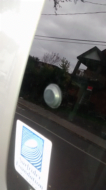

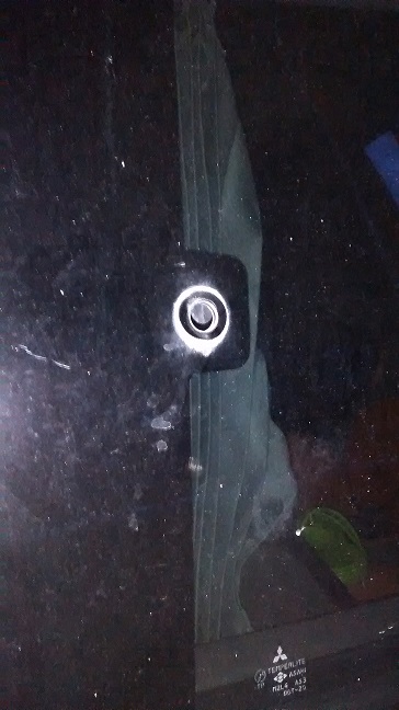

The plug that holds the articulating arm portion of one of my rear pop-out style windows has rattled out and is lost forever. The small bolt remains, so i'm just looking for the plastic plug that goes on the outside and into the hole on the window to connect the articulating arm.
wish I knew the more specific name of said piece, so I attaché a couple photos, one is the other window and the "plug" i'm looking for and the other pic is the remaining hole.
does anybody know if this is a standard piece among minivans in general or specific to the L400?

The plugs cross reference to an 80's Colt. I bought some not long ago. Let me see if I can find the receipt.
Knibby
Posts: 12
Joined: Sat Apr 19, 2014 8:19 pm
Vehicle: 1996 Jasper
Location: Kimberley
Re: rear pop-out window "plug" needed
Post by Knibby »
Coombs sent me some off one of their wrecks for under $15 for the set.
Mitsubishi part number MB106810. They're actually rubber with an aluminium core- but over time the rubber hardens.
I recently bought a full set of 13 from Amayama.com, but they sell them individually too- they're about $2.50
