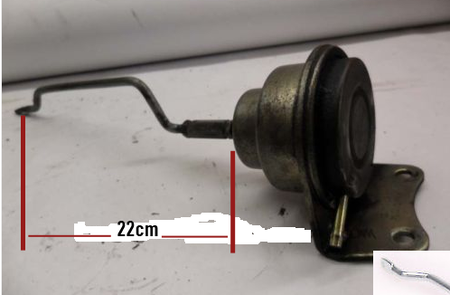

I think I know what you mean, but I need to clarify a couple of things:
-The "valve" that connects to the lever arm is the Wastegate Actuator. It's the tin can shaped thing with a vacuum hose connected to it, right?
-You say "underneath the turbo"- on most Delicas the wastegate actuator is *above* the turbo, by the inlet manifold, connected to the lever by a long rod. (Pajeros have the wastegate actuator underneath the turbo, and maybe some Delicas made after 1995).
Anyway:
The wastegate actuator has a spring inside that pulls on the connecting rod, normally holding the lever arm up (closed). When the actuator opens the valve, the connecting rod is pushed out of the actuator.
On a regular, actuator-above-the-turbo Delica, the connecting rod should be 22cm long, measured from the lever arm pin to the actuator. If you make a new connecting rod that's the wrong length, you'll change the amount of boost you get before the wastegate operates.
HTH

its reverse thread on one side. Also tuning by length is a good start but not really reliable. Depending how worn the spring is will vary how short the rod needs to be. A worn spring will require more preloaded thereby shortening the rod length. Best to get a boost gauge.
Do not drive with the actuator disconnected. You will billow black smoke and your egt temps will sky rocket. Your motor requires x amount of air to balance put the fuel. Same goes for wiring the gate shut. Depending on your pump settings you can easily over boost the motor.

I would doubt it, but the only way to know for sure is to go to the shop and ask. Even Mitsubishi only sell it as part of the whole actuator assembly. The problem is that it's a right hand thread on one end, and left hand thread on the other.
You need to find a clever and creative engineer. I reckon you could make something that clamped the existing rod to the actuator.

Driving with the valve disconnected won't cause any harm- the wastegate will stay open and prevent the turbo from making any boost, and without any boost the fuel injector pump will operate the same way as a non-turbo engine. You won't be able to go very fast though, the turbo is a huge restriction in the exhaust *and* the inlet. You might make a bit more smoke, due to the exhaust restriction.

Yes. The wastegate actuator contains a spring that tries to pull the wastegate closed, while boost pressure tries to push it open. Shortening the rod puts more tension on the spring, meaning it takes more boost before the wastegate will start to open.
Be careful though- if you make the rod too short the actuator can run out of travel before the wastegate is completely open, leading to over boost.

I used to get 12psi from shortening the shaft without issues, but beware that your pressure relief valve (flat topped mushroom thing at the back of the inlet manifold) might start to vent pressure at 12psi.
