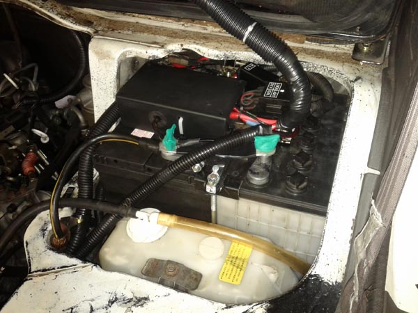

My question now is...how do I get the batteries out? I simply can't reach the positive terminals hidden underneath the chasis part of the car, and I can't remove both batteries to detach them because the terminals are connected to wires that are tied/taped in. The terminals parts of the connectors appear to be welded together (ie. the wire leading to the car, the terminals on the batteries and the bridge between them are a single piece) in the front and back...anyone have a guide? Can't seem to find in the owners manual or service manual.

My dual-battery setup isn't factory and there might be something about a Chamonix setup I'm misremembering, but there should be enough room to get a spanner onto the rear terminals and detach them. There may be bleeding involved.
I'd detach the negative terminals first, then the positive- less chance of shorting out the spanner on the bodywork that way.
To remove the batteries on my van I have to lift the overflow bottle out of the way before the first battery will come out.
(For reference. The ridiculous wiring is because it's a camper setup- one battery is for starting, the other is a deep cycle for everything else. The starter battery is isolated whenever the van's not running.)
