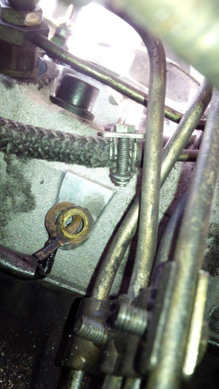

Found the problem. Turns out the mechanic did not connected the ground to the engine where it<s suppose to be. So now I have to either find the proper bolt to fit in, or rewire to another ground.
I will also test the ECU afterward to see if it was also the same problem.
Again thank you for your help!
Fred

Here it is. And CC Autos just gave me the size.
Cheers!
