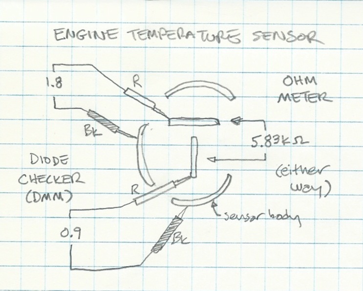

35 seconds @ -5C (Stock Green Cap brand new Glow Plugs, was the same timelaps with old ones). A bit of choke help but running well as ever)
Notes: If restart when engine warm, will take about 20 seconds for second click then a 3rd one right after starting to mark the smoth iddling. Temperature sensor changed recently. No electrical-mods work since longer second click timelapse: had usual 3-6 seconds seconds click before or when engine warmed.
Update: Here are my Engine Temperature Sensor readings: where it should read 1.8 mine is 0.81, 5.83 mine = 3.85, 0.9 mine = 3.05, Engine at garage temperature = 20C.
