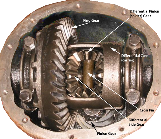

They're fairly simple, and installation isn't too tricky either. Here's your existing open differential:
Some basics first: The ring gear drives the differential case with cross pin, the cross pin pushes the pinion gears. The pinion gears drive the side gears, and the side gears drive your axle shafts (the side gears are separate from the differential case- free to rotate independently) .
Though the cross pin is applying power all the time, the pinion and side gears together allow the axle shafts to turn at different speeds, like when you're cornering. Normally this is a good thing. However if one wheel lifts off the ground (or has less traction) the gears allow that wheel to spin as fast as it can, while the wheel with traction receives no power at all- turning your 4WD into a 2WD just when you need 4WD the most.

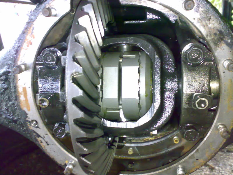

A Lokka replaces the pinion and side gears like so:
The cross pin still drives everything, but the gears have been replaced with a block of metal with some springs and interlocking serrated faces. The gap in the middle is held apart by light springs. In normal use, the serrated faces mesh together and lock the two axle shafts (in the photo the left side is meshed, the right side is unmeshed). The serrated teeth are actually slightly tapered, so when one wheel is being pushed faster than the other (like when you're going around a corner) the teeth un-mesh and allow the axle to slip one tooth. When under power, the cross pin is pushing on the two metal blocks, overcoming the light springs, and forcing them to stay locked. That way you get differential action when you need it, and 4WD at all other times.
The locking action can make steering a bit heavier when in 4WD- people with large tyres (33" or so) notice it more- but in 2WD with the hubs unlocked it makes absolutely no difference.
Installation is straightforward: remove differential (marking everything for correct reassembly), remove cross pin, replace gears with Lokka, reassemble.
As long as you haven't mixed up the bearings or spacers, your differential setup will not have changed. The Lokka is designed to work with standard size thrust washers- during installation you're supposed to check the clearance with a feeler gauge, and if it's out of spec you'll have to replace your thrust washers. This should only be an issue with a rear differential, as our front diffs shouldn't see enough use or power to have worn out.
More detailed, installation instructions here: http://www.aussielocker.com/downloads/a ... manual.pdf (the Aussie Locker is the US marketing name for a Lokka)
