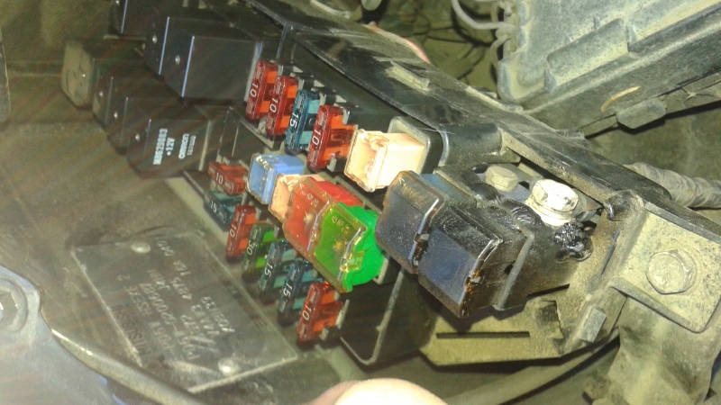

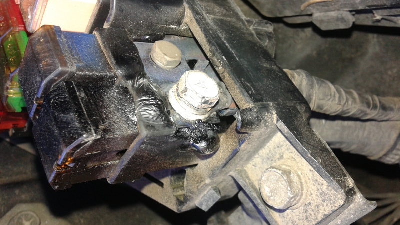

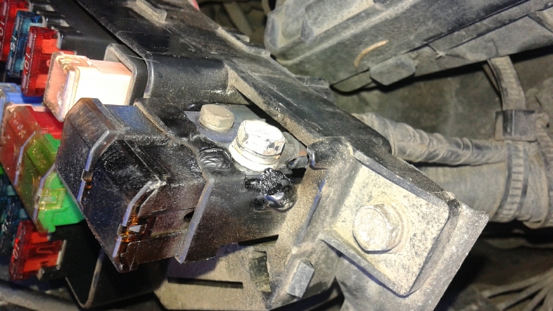

Here are the fuse pics. I assume it's the alternator fuse from a few diagrams I found online as well the Google translate of the fuse box cover. They and 100 a and 80a fuses

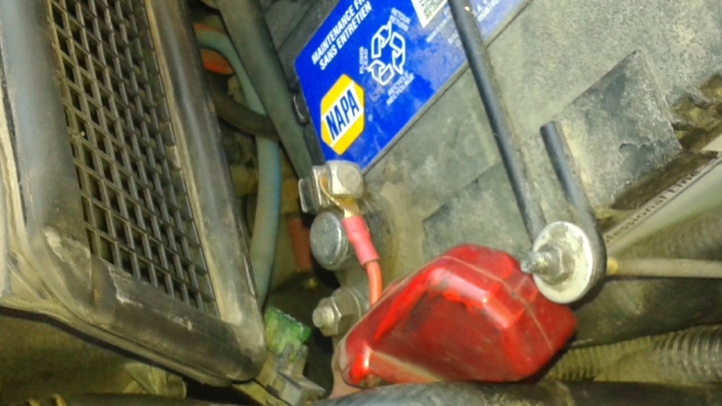

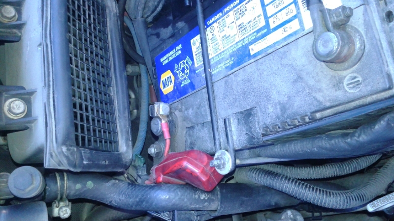

Also a pic of a strange wire on the positive post which goes into the cab on the passenger side. I had to disconnect it to get the booster cable on.

The mystery wire. The blue casing leads into the body.tried a bunch of times but forum doesn't like that pic.
