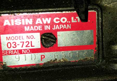

Incidentally, the "L" in the Aisin model number means it has a lockup torque converter. Not all L300s had this. The best way to check is to look at your transmission's ID plate:
("91" is the year of manufacture, "D" means April (A=January and so on) and 65014 is the actual serial number.

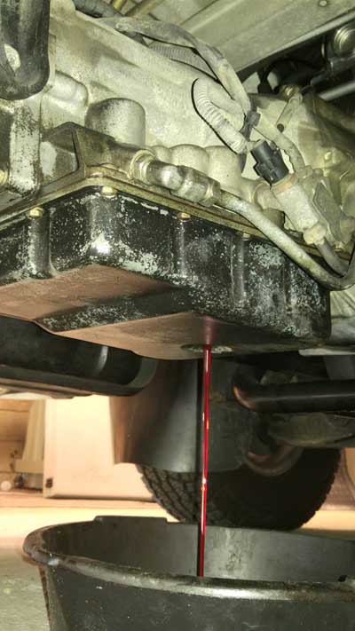

Drain the transmission fluid from the pan.

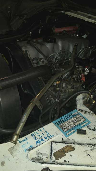

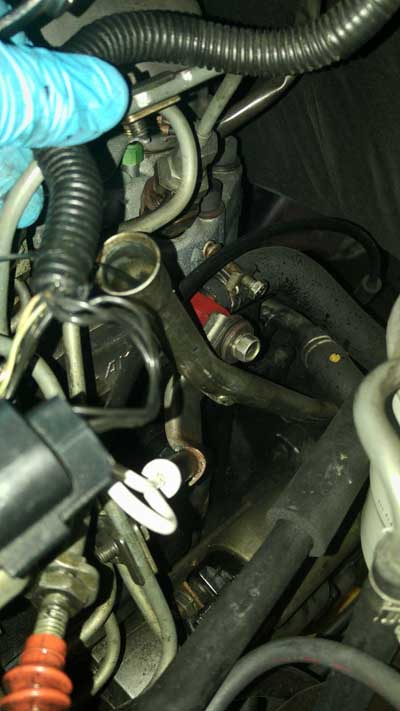

Detach the dipstick tube- there's a single 12mm bolt near the top. The tube has an O-ring where it joins the pan, and it can be difficult to separate the two- it's much easier to do it from above, rather than from underneath while it's raining ATF on you.

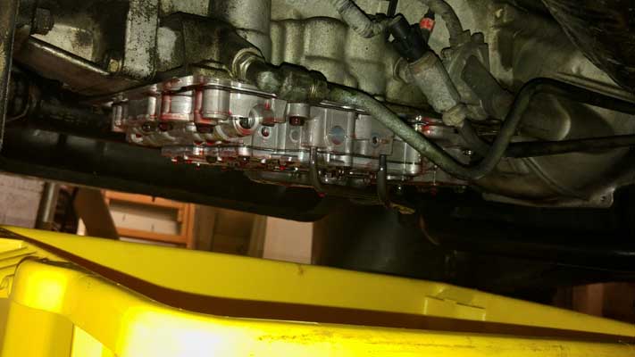

Remove the pan- take note of how loose the 10mm bolts are. They should be little more than hand tight (4.5Nm/3.3ft.lb). From the factory the transmission had a gasket, and if yours is still there it should come away cleanly and be re-usable. If it's been replaced with silicone gasket then you're going to have to gently cut the pan off.

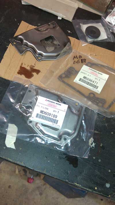

Unbolt the mesh filter from the underside of the transmission and replace with a new one. Again, note that the 8mm bolts holding it on are little more than hand tight (5.5Nm/4ft.lb). Take care when removing the screen- there's about a pint of ATF trapped above it, and it all falls down -sploosh!- when the screen comes off. I didn't take photos of this bit because it was raining transmission fluid under there, but here's the new screen and gasket before installation (and the old one with gunk visible on the mesh):

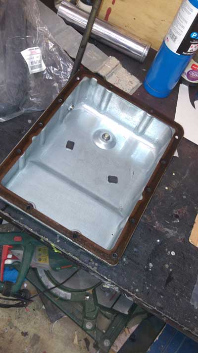

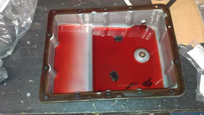

Next clean the pan and the two magnets, while being thankful there aren't any large metal shavings or gunge in there:

In my case, the old filter was more than half clogged- and with the new filter the gearshifts are back to normal. Phew!
