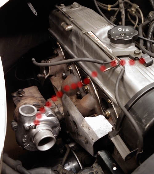

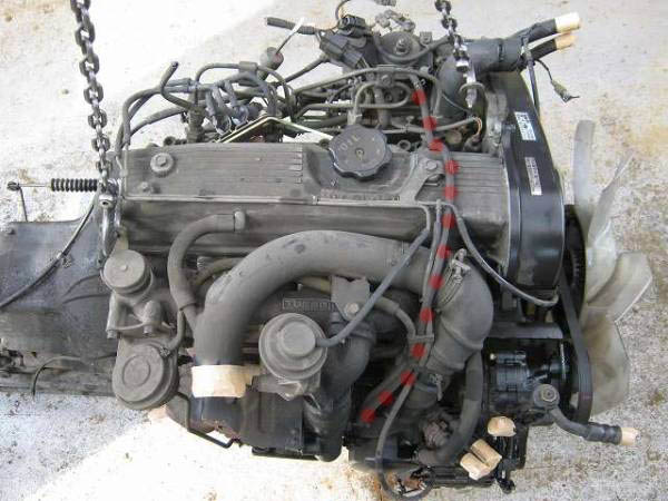

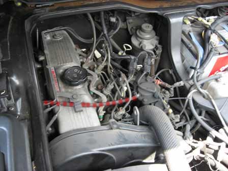

Regarding the oily turbo, I have a theory: There's a small tube that connects the turbo to the fuel injection pump, so the pump knows what pressure the turbo is running at and can inject more or less fuel to compensate. If that hose pops off at the turbo end, the pump will not inject enough extra fuel and it'll be very slow. Also, oil will come out the disconnected fitting on the turbo and make a mess. Here's what the tube looks like with the engine cover open:
And here's where it goes when it disappears under the drivers seat:
There's a whole heap of parts not installed on the second picture, TBH it's a bit of a nightmare in there. The best way to get at the turbo is to remove the drivers seat, fold back the carpet, detach the handbrake and fuel flap cables, then remove that section of floor. Check both tube fittings, add small hose clamps if necessary, check the tightness of the hose clamps on the turbo's outlet. Check the large bolt on top of the turbo that holds the oil feed pipe in place, but *dont* overtighten that one- it's a hollow bolt and will snap off if you're not careful. A torque wrench and a workshop manual from the FAQ/downloads section is your friend. Or maybe find an actual friend who has some mechanical experience :-)
Driving from LA to SF at 4000rpm *shouldn't* have broken the turbo, and if it had the oil would be on the inside of the engine, but it's a really *really* good idea to figure out where the oil is coming from and fix it.
These engines are very basic, strong, and reliable, as long as they're assembled correctly. It sounds like yours might have been put together a little bit poorly- fix the issues and there's no need for it to be a money pit.

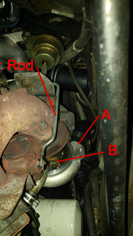

Re: New Delica Owner - Low power, leaky turbo, running cold
Here's a more realistic picture of the tube on the turbo side:
Eww.
1. The oil could be coming from the turbo's outlet- it's connected to the inlet manifold by a short rubber pipe, and if the hose clamps aren't tight enough oil can leak out of there to make a mess (point A on the photo). it could also be the oil feed into the turbo- which is behind a heat shield, so you can't check it easily, but I'd expect the oil to be dripping down from the centre part of the turbo (point B). It could also be the typical valve cover leak- that oil can end up anywhere. Note that my turbo is on a slightly different angle to yours- point A is not going to be that easy to see.
2- Sounds like your temperature gauge is correct and the thermostat needs changing (or installing, if it's not there). Conveniently, the thermostat is down by the turbo so you can check all the turbo's other hose connections while you're there. Or inconveniently, if you were imagining an easy job. ;-)
The thermostat housing is at the top of the lower radiator hose, it's held on by two 12mm bolts. You'll need a new gasket as well as a new thermostat. Since you'll be cross-referencing at the parts store it might help to know that thermostat and gasket kit is Mitsubishi part number MD997606, gasket alone is MD149407.
I'm beginning to think your transmission is ok, it's the lack of power that's messing things up. There are a couple of other things to check on the turbo- like the wastegate. The rod in the picture should have some spring tension on it holding the wastegate lever up/closed- if you pull down on the rod (hard- it's under quite a bit of tension) you should be able to move it and open the wastegate. When you let go the wastegate should close with a click or snap. Sometimes the split pin holding the lever and rod pivot together falls out and the wastegate can just flap open, which means no boost.
Another thing to check would be the boost compensator diaphragm on the injection pump- where the boost hose goes in, the top cover is held on by four 10mm bolts. Lift the cover off, mark the diaphragm so you can replace it in the same orientation ("reference mark" in the picture), and lift the diaphragm out. Check for splits or holes in the diaphragm. (ignore "stop screw" on the attached photo- we don't have one of those). If the diaphragm had a split, then the boost signal would also be lost.
