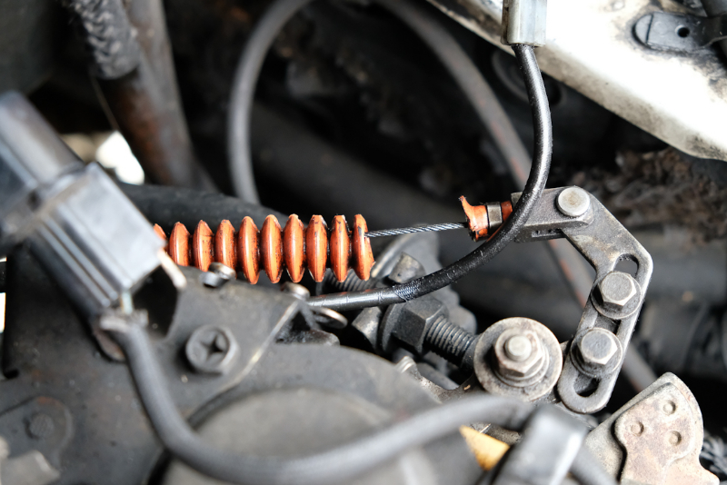

KickdownCableIns copy.JPG (34.03 KiB) Viewed 7499 times

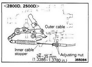

First pull back the orange boot and check that the inner cable stop has 1-2mm of free play when the accelerator is at rest. Adjust by loosening the two 10mm bolts on the linkage and lengthening or shortening the linkage.
Now hold down the accelerator as far as it'll go, check that the cable stop is 34-35mm from the inner cable (as pictured). Adjust using the two 14mm adjusting nuts on the outer cable. Re-check and adjust the first measurement- you may need to go back and forth a few times until both measurements are correct.

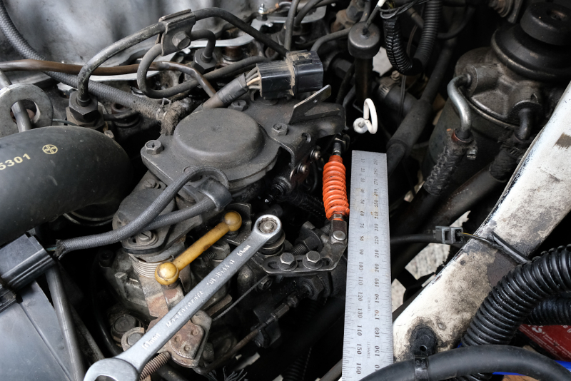

My measurements seem to be within spec; 35mm @ full throttle, ~2.5mm at rest. Measuring the smaller one is a little difficult, but it's under the 2.5 mark on my metric ruler ...

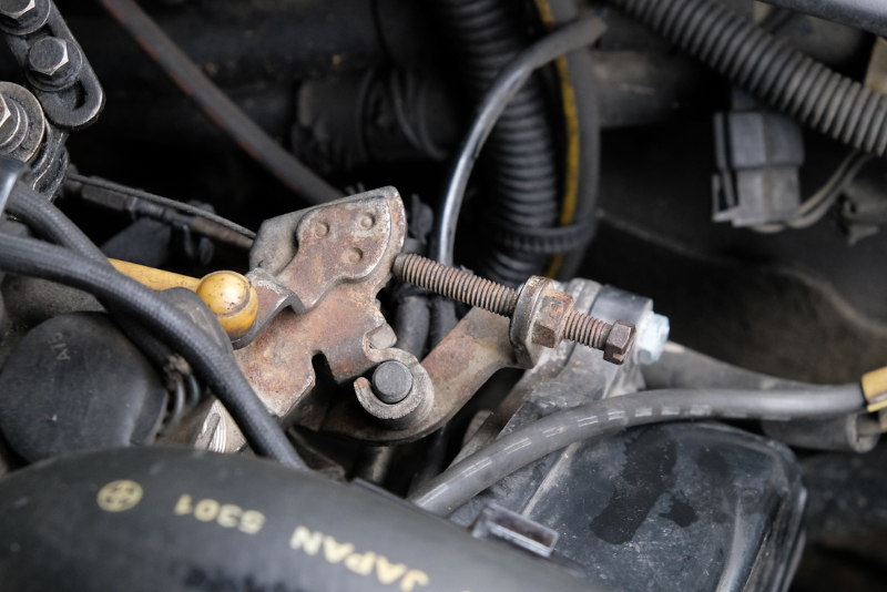

I'm having trouble finding which 10mm nuts do the adjusting. The larger 14mm adjusting nuts are obvious. I put a wrench on the only 10mm nut I can find on the linkage to point it out, but I'm not confident this does the adjustment? The two other nuts to the bottom right of the wrench are 8mm; I think they're the ones discussed in the TRL version of this post
Growlerbearnz wrote:"If you find it impossible to achieve both measurements (free play *and* full throttle), you can alter the length of the lever that pulls the cable by loosening the two 8mm bolts. You shouldn't need to do this as it's set at the factory, but who knows what's been done to your engine before you owned it."

Sorry, this post says "10mm" where it should say "8mm". I corrected it in the TRL verion but forgot to go back and edit the original post.
I think you've figured it out though. The 14mm nuts adjust the cable length so you set the "at rest/idle" 2.5mm, the two *8mm* bolts adjust the stroke length so you can set the full throttle 35mm.
