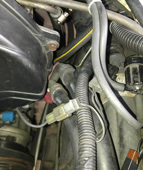

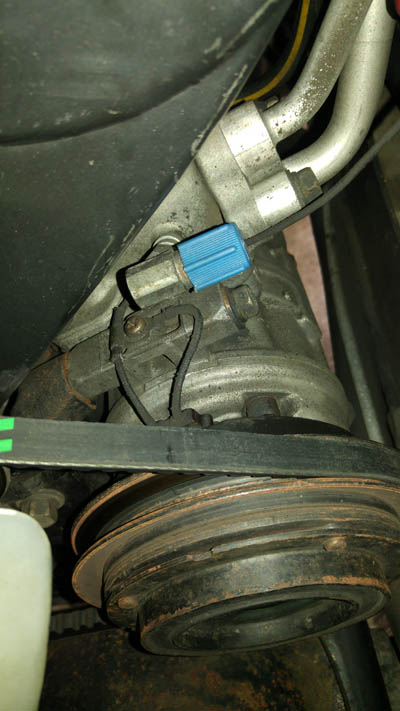

Hi,
I can't seem to find where to connect the 12V wire that should go to a/c compressor. Mine somehow came off - not connected any more, compressor won't engage.
Tested - the wire shows 12V when a/c switch is pressed.
Attached 2 pictures ... mine looks the same. Strange the wires attached to the compressor only connect to (-) .
Where do I connect the (+) 12 V wire ? Puzzled....

I have L300 1993, I am sure it is the stock compressor identical to the one in the ebay URL above.
On these pics you will see 2 wires attached to the compressor
- one short screwed in to the body of the compressor (ground (-))
- another goes UP and eventually connects to battery's (-) - so another ground connector (??).
Don't see how to connect (+) 12v wire.
I hope someone can check the same on their Delicas or I'll have to visit CVI/Japanoid ... to sort this out.

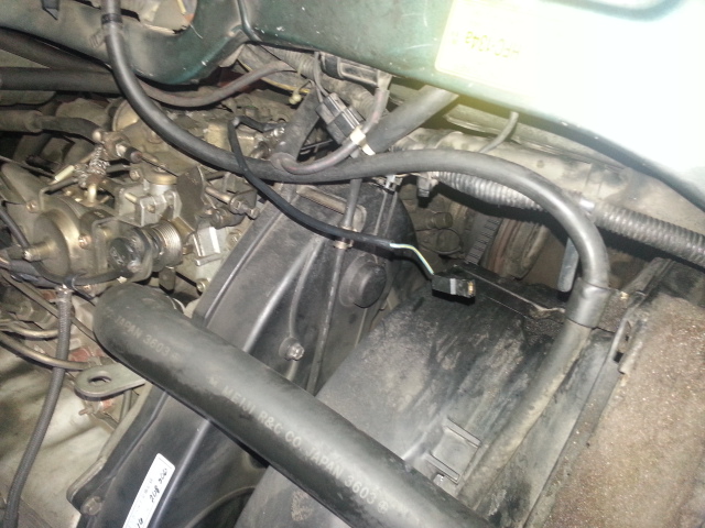

You made me realize the cable I am chasing is not going to compressor.
It is a part of the A/C as I only see 12V on it when a/c button is pushed on. It is probable going to one of the relay / switch ?
Where does this one connect to ?

do I understand this correctly that compressor will get the (+) over engine body ... that's why the other wire on it seem grounded ?
So my hanging wire is yellow & blue.... to it should go to thermo switch which is grounded (allows current over body to the compressor unless temperature riches high) , right ?
Any chance you can send me a pic of that to be sure (blue & yellow wire connecting to the thermo switch) .

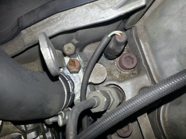

is this the one (thermo switch) where I need to connect the wire to ?
After looking at the PDF & a few other pictures I had no doubts that's the thermo switch.
Attached my wire to it & compressor is back in business. Suspect it was disconnected last November when all the belts +water pump were replaced & never connected back until now.
