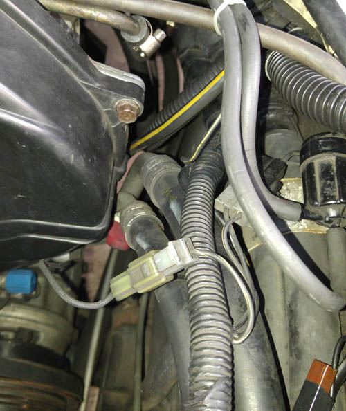

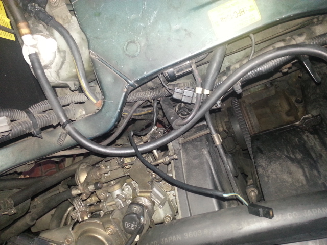

I can't seem to find where to connect the 12V wire that should go to a/c compressor. Mine somehow came off - not connected any more, compressor won't engage.
Tested - the wire shows 12V when a/c switch is pressed.

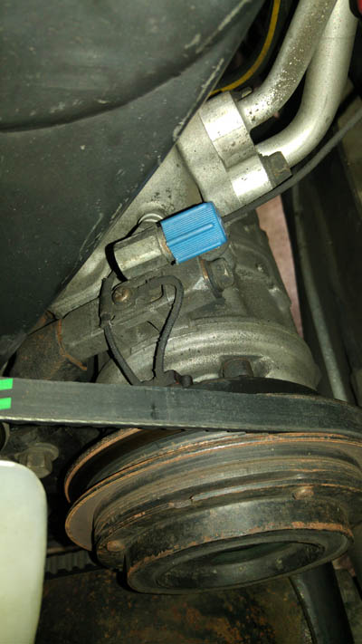

Attached 2 pictures ... mine looks the same. Strange the wires attached to the compressor only connect to (-) .
Where do I connect the (+) 12 V wire ? Puzzled....

I have L300 1993, I am sure it is the stock compressor identical to the one in the ebay URL above.
On these pics you will see 2 wires attached to the compressor
- one short screwed in to the body of the compressor (ground (-))
- another goes UP and eventually connects to battery's (-) - so another ground connector (??).
Don't see how to connect (+) 12v wire.
I hope someone can check the same on their Delicas or I'll have to visit CVI/Japanoid ... to sort this out.

The long lead from the compressor clutch should connect to a black with white stripe wire. It comes out of the wiring loom at the same point as the idle-up vacuum solenoid wires (one of which is also black with white stripe. Easily confused with battery (-) wires, which are black with white stripe *plus* red spots. Thanks Mitsubishi.)
The aircon compressor is run by the time delay relay behind the glove box- it delays compressor turn on by about 4 seconds, presumably to prevent any chattering. If you test the black wire with white stripe you'll find it's earthed until the time delay relay turns on, and then it goes to +12V.

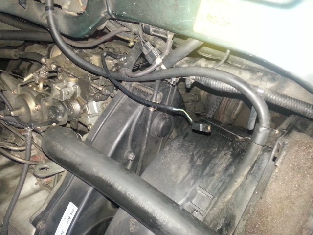

You made me realize the cable I am chasing is not going to compressor.
It is a part of the A/C as I only see 12V on it when a/c button is pushed on. It is probable going to one of the relay / switch ?
Where does this one connect to ?

Blue with yellow stripe wire? That should connect to a thermo switch in the radiator hose stub. The thermo switch should be earthed unless the coolant temperature exceeds 115C. When the thermo switch opens it disables the AC. If that wire isn't connected to earth, your AC will think the water temperature is too high all the time and won't work. On my engine the thermo sensor failed, so I just replaced that spade terminal with a ring terminal and earthed it to the engine bay (the screw that holds the idle-up solenoid in place is convenient).
There should also be a black wire coming out of that sleeve alongside the blue/yellow one. The black wire goes to a second thermo switch in the same area, and turns on the radiator condenser fan if coolant temperature exceeds 105C whether AC is on or not.
If you have both thermo switches (and both wires), you'll need to put a multimeter on them when cold to figure out which one is which. Blue wire with yellow stripe goes to the one which is earthed, black wire goes to the one which is open.

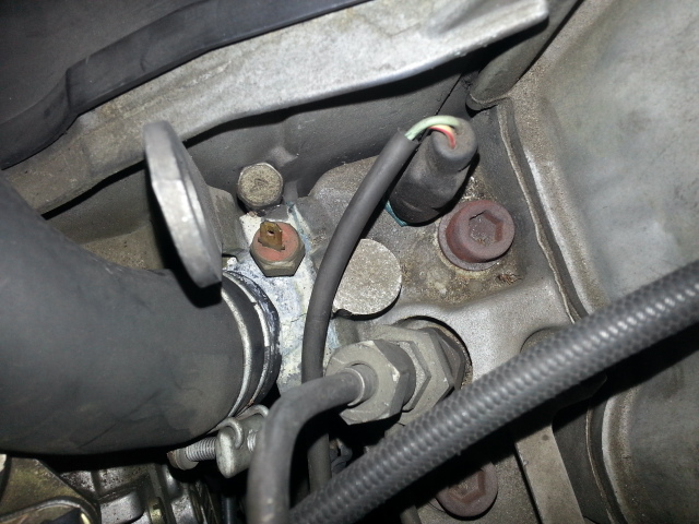

is this the one (thermo switch) where I need to connect the wire to ?
After looking at the PDF & a few other pictures I had no doubts that's the thermo switch.
Attached my wire to it & compressor is back in business. Suspect it was disconnected last November when all the belts +water pump were replaced & never connected back until now.

Yes, you are correct. The compressor gets (+) through the black/white stripe wire (long wire from the compressor), then to earth through the short wire on the compressor.
The thermo switch in your photos looks like the correct one to connect the blue/yellow wire to. If you can test the thermo switch, check that it is connected to earth, but you won't harm anything by just connecting the blue/yellow wire and seeing what happens.

Updated my previous post, but will confirm here again that connecting that wire to the switch made the trick - all good (cold ) now with A/C.
