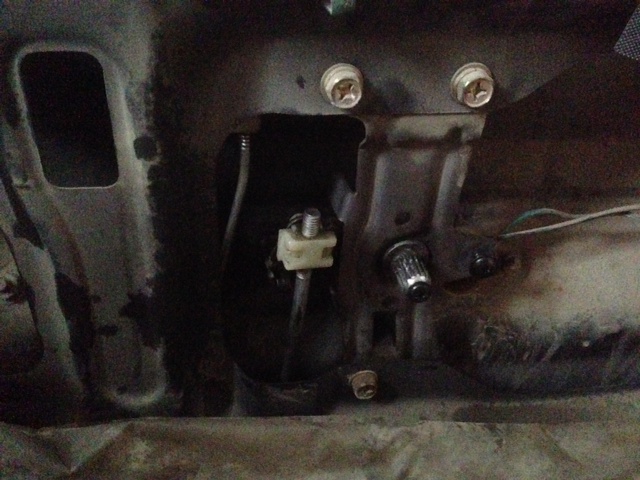

Hi, My rear gate latch is stuck closed (1991 L300). I've taken off the back panel, WD-40'd the lot, wiggled all the bits that I could, incl with vise grip pliers, but it still won't budge (the lock tab moves up and down, but the latch mechanism won't budge). Handle is stuck in. Any thoughts much appreciated!

Thanks for the tips! Perseverance was the name of the game- just continued to wiggle gently and lube, until I heard a "click" and it un-latched itself. After that I was able to open the gate and take the lock out from underneath and give it a clean. a bit rusty too. Also, the rear handle catch had slipped below the rod it connects to, so had to put that back into place. Now just hoping it continues to work!

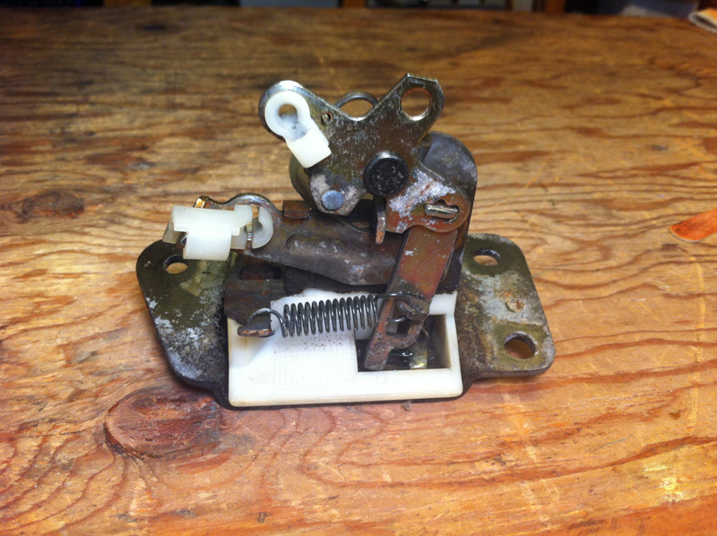

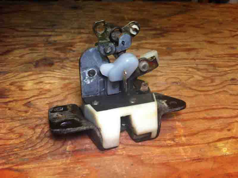

Thanks for your post Falco, that helped when I couldn't get my tailgate open.
I always thought it was strange that there was no way to unlock the tailgate from the inside. I even had the interior panel off before and the third tail light removed and never noticed that lock/unlock button! I never know whether it's better to leave the tailgate locked or unlocked while camping. Unlocked: it would be startling if someone opened the tailgate while I was sleeping. Locked: to wake up with the engine on fire, and want to escape through the tailgate but unable to unlock it. Hm, I'm thinking of a workaround so I can access that plunger...
Anyway, I removed the latch mechanism from the tailgate. It was useful to put three pieces of masking tape on the connecting rods before undoing the plastic clips, so I could put them back in the same positions upon reassembly. I washed the latch thoroughly in bicycle chain degreaser (a detergent available at MEC) and applied grease to the latch, and oil to the mechanism pivots. And I cleaned the electrical contacts and smeared them with a little vaseline to prevent diaper rash (or corrosion from forming).
There's mention in this thread also of the metal tabs that attach the inner and outer skins of the door (and come loose over time). I had previously rejoined most of them with butyl tape (IMHO the best product for the job) but having run out, I mended the two remaining (since I still hear a rattle from the back) with some silicone leftover from sealing the shower stall. It's probably not high temperature enough for the application, but what the heck.
Got the tailgate all back together, with some minor whining about the plastic clips that attach the interior panel, and how did this stupid design ever become an industry standard. Oh poop.
Here's the only photos I took of the procedure, just a front and back view of the latch mechanism, in case anyone needs to see what they can't see while it's buried in the tailgate. Hard to believe there's a solenoid somewhere in there. No harder, I suppose, that there's a lock button under the third tail light.
