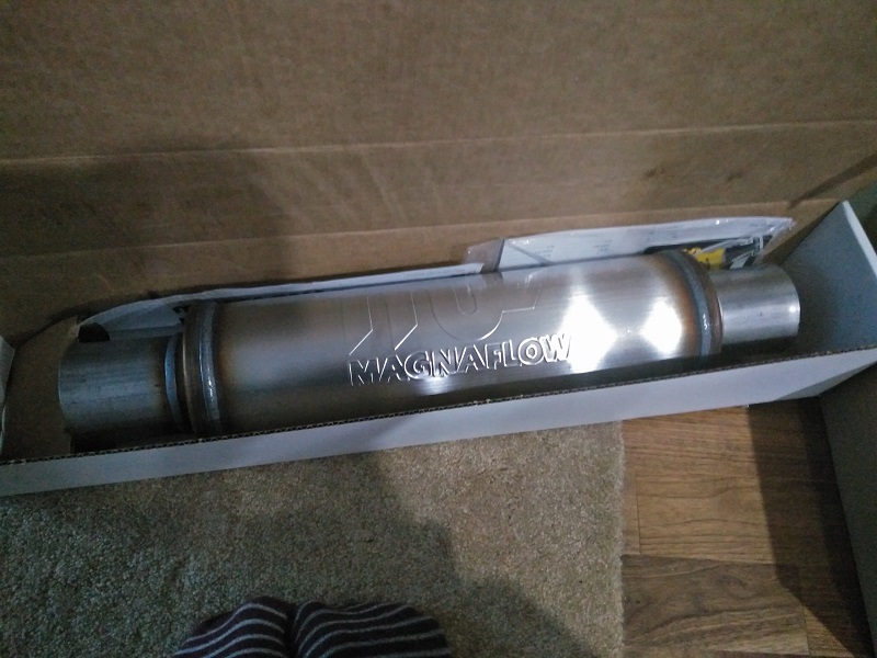

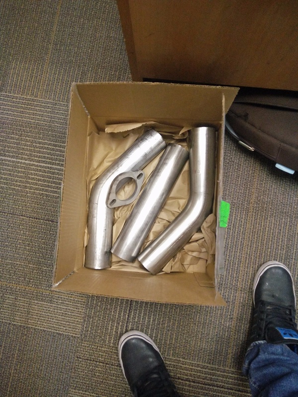

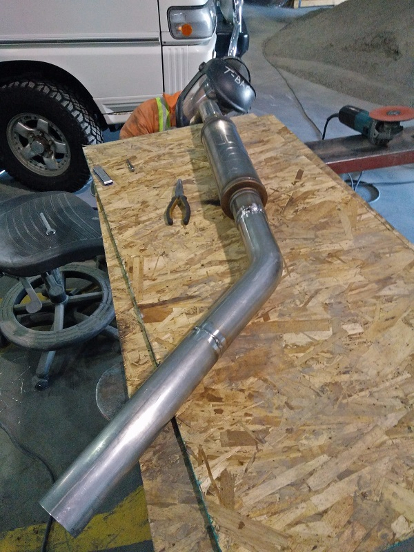

Just though I would share some pics and info on my side exit exhaust my friend welded for me this past weekend.
Parts:
4" Magnaflow round muffler Part number 10416 from amazon.ca: $100
Two 45 degree 2.5" stainless mandrel bends from Columbia River
One straight stainless pipe 2.5" from Columbia River
One 2.5" 2 bolt stainless flange from Columbia River (the Combined piping and flange was $145)
One 12" long straight stainless rod for the exhaust hanger from mufflertech: $15
I apologize I didn't take pics of the whole process.
I had a bolt spacing of 92mm and read on the forum that a 2.5" flange would work. We had to grind out the bolt holes on the flange a bit as they were too small.
The 45 degree bend off the downpipe/turbo manifold was not ideal as it angles down a bit too much. We compensated this a bit by cutting off two inches off the top of the first bend. Other than than, it was the perfect amount of piping.
Bent the rod with a torch and vice for the exhaust hanger. Used the drivers side original muffler hanger mount.
I haven't put a gasket in yet but doesn't appear to be leaking.
Noticeable drop in EGT's thus far. ~100 degrees maybe. Also sounds pretty cool. It wasn't even that loud when I fired it up without any exhaust on.

- Muffler
- IMG_20160608_182056 2.jpg (148.57 KiB) Viewed 11954 times
- Piping and Flange
- IMG_20160609_101051 2.jpg (539.8 KiB) Viewed 11954 times
- Tacked in place
- IMG_20160702_160717 2.jpg (152.82 KiB) Viewed 11954 times
