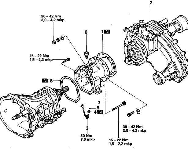

The lights can be undone from the outside with a cross head screwdriver, to check the bulbs. The next suspect would be the switch. It lives on the right side of the gearbox (underside), with a cable bolted to the gearbox in 4 places. Number 3 here:
Follow the cable to the 2 connectors on top of the gearbox.
Undo the connectors and short the two wires on the car side of things. That should make the reversing lights come on (with ignition on) if fuses and bulbs are OK.
