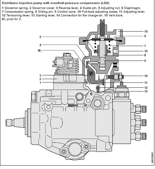

Re: Sudden loss of power.
Jedidiahwiebe wrote:Okay, awesome. So the boost pin is the thing he calls the 'governor' pin at 40 seconds into the video then? https://youtu.be/zvnQEIcrgWs?t=40s So when that get's seized it means that the rpms will govern out at lower rpms?
That's the one. Bosch call it a guide pin. I wouldn't have called it a governor pin because it controls fuel quantity under boost rather than engine speed. (but it does so by operating the governor linkage, so technically it could be called a governor pin, though it's misleading.)
Ya know what: let's use the words Bosch, the inventor of our VE pump, uses.
Right. when there's no boost, the diaphragm (6) and sliding pin (8) sit up high, so the control cone (9) pushes the guide pin in. Once you have boost coming in the charge port (14), the diaphragm is pushed down, and the control cone allows the guide pin to extend, allowing more fuel to the injectors. If the guide pin is jammed it wont move out, and you'll never get the extra fuel you need to make power from the boost. The engine will run just fine, it will just make as much power as a non-turbo engine.

Post by Jedidiahwiebe »
It is truly a brilliant system! Thanks for the extremely solid replies. The diagram is just what I was looking for! Sooo I did the procedure outlined in the video you originally posted growlerbearnz. It went extremely well. Perhaps a little too well. Perhaps it was not stuck. After reassembly it ran about the same :-( Acutally I think it's getting worse. Now i can't get it above idle at all. Smokes a little black blue and white now.
