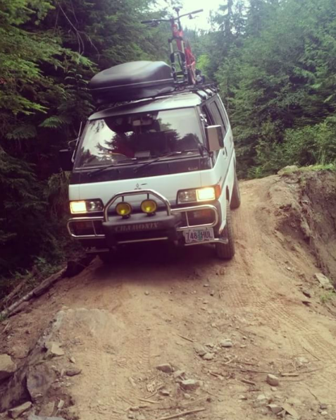

Hello fellow forumers!
I was out last weekend trying to drive through a washout on a dirt road. This was my first experience with my Delica and 4WD.
I stopped, shifted to 4H, drove forward a bit until I heard clunks and "wheel lock" appeared on my dash. I then tried to shift to low range and my stick simply wouldnt go far up and right as prescribed. I could go in and out of 2H and 4H but could not get the stick into 4L.
NOTES:
I was *not* moving when I tried to go from 4H to 4L...
I was in neutral (but I have a 5-speed)...
I had my foot on the brake...
***Any ideas why my Deli can't get into 4L? What is this noob missing?!***
Other things to mention:
I went for the washout in 4H... almost made it.. but stopped a bit short. my rear passenger wheel left the ground and my front driver side was digging a hole. I heard some "bad" noises when I went for it again. Sorta "clicky" noises. Perhaps only one wheel was locked? In the end, I gave up, reversed out of it and didn't end up with a deli in the ditch.. phew! :shock:
proof:
Screen Shot 2016-08-27 at 9.38.14 PM.png (516.95 KiB) Viewed 5831 times
Thanks much!!!
Scott
