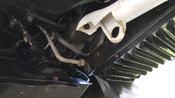

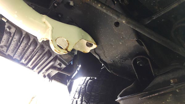

Installation of Delica Front Bull Bar
Here we go- left and right mount points. It's tricky to get a good photo as there are lots of things in the way, and it's raining so I wasn't going to roll around on the ground:
On each side it's just a single M10x1.25 bolt that goes into a captive nut in the chassis rail.

Hi,
Thank you very much for the images and your ideas. Yes there is a different of chassis. but that might not be a big problem i will do something for that.
Other thing is only that bolt is enough for fix this bull bar? i mean strength is enough? or is there any other place to put some bolts? (either side of oil cooler)???
Anyway i got the clear pictures thanks again.
