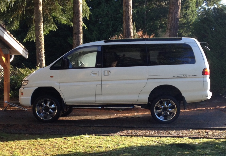

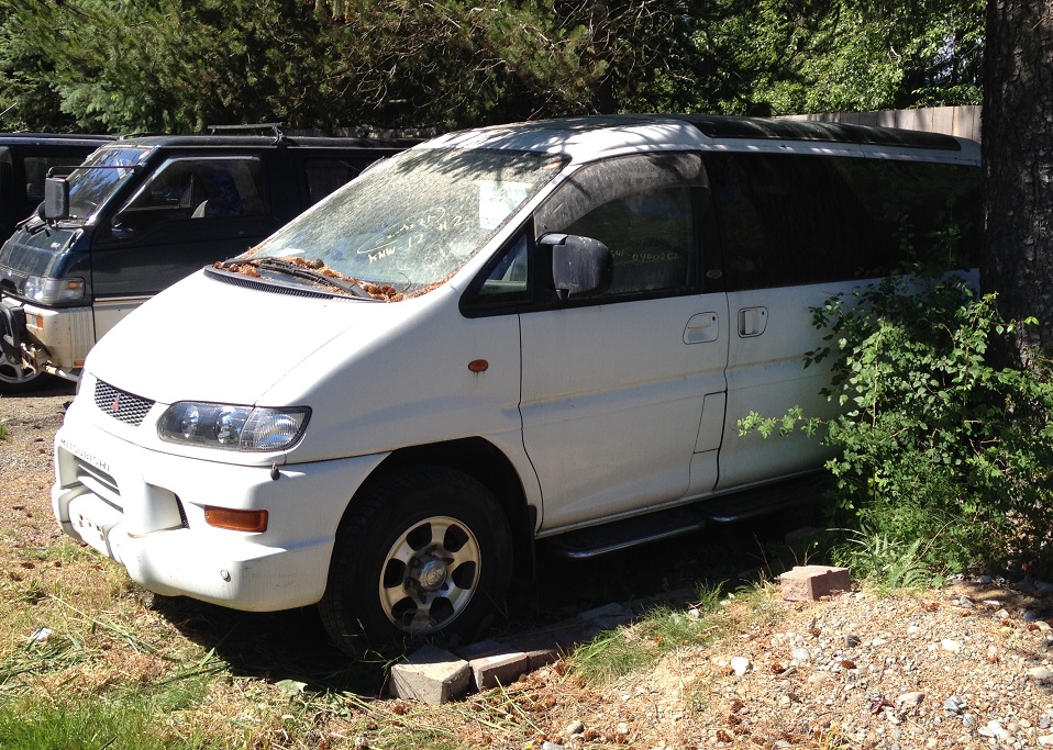

So the new project has arrived, a 1998 L400 LWB 3000 V6 (6G72) S2 Delica... a first foray into Mitsubishi after years of MR2's. The purpose for this vehicle is highway cruising/hauling, with good handling, and upgraded power, for the very smooth roads of Vancouver Island. Yes sure, there is plenty of off-roading here too, but that is not the purpose for this ride. Looking for road-holding on sweeping 120km speed-limit curves.

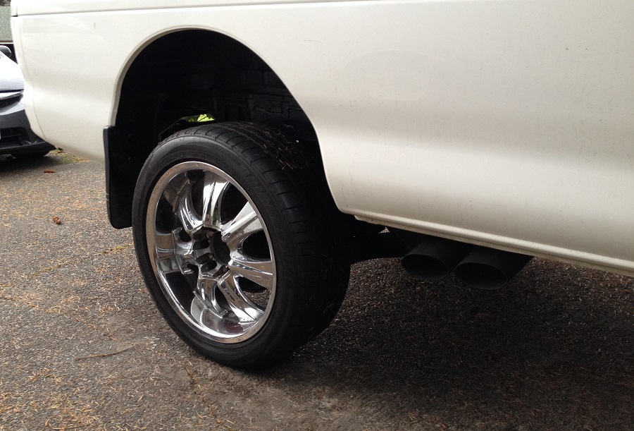

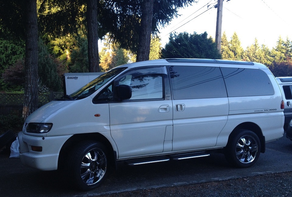

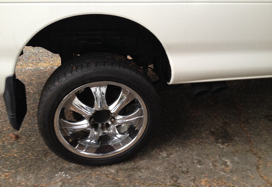

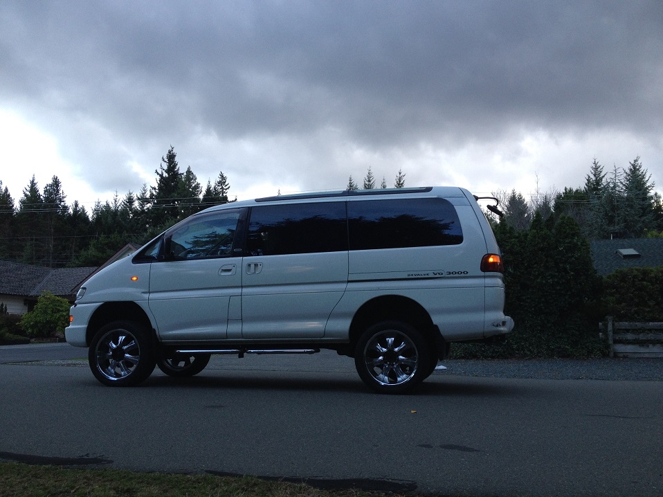

First things first, wheels and tires were already purchased for this vehicle before the vehicle was obtained, haha. Priorities are important. So, to make a big lunker stick, those 80-series tires GOTTA go. On are going:
255 45 20 Duelers on 20 x 8.5 VW 750 Velocity's, +30 offset
So still a 29" overall diameter.

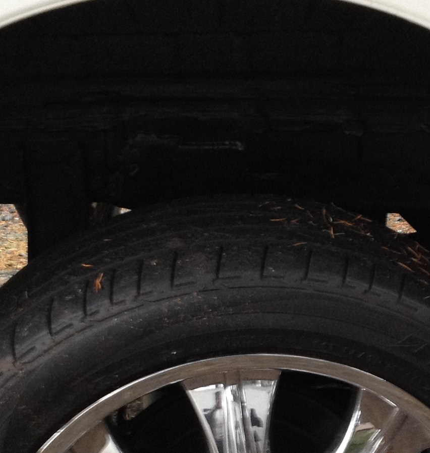

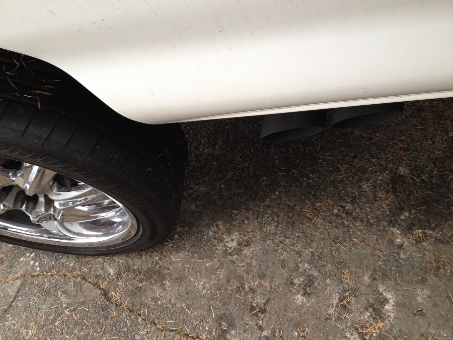

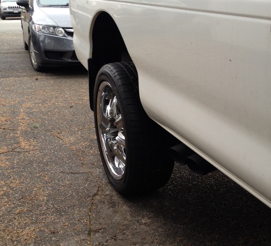

This thing got delivered and 20 minutes later, the new tires/wheels were on for a test fit, and they fit perfectly, no rubbing lock-to-lock etc (whew! off to a good start):
Haven't decided on center-cap area yet, don't care so much for the caps that come with these wheels, may incorporate the Mitsu caps somehow, or just black out everything in the center and leave as is...

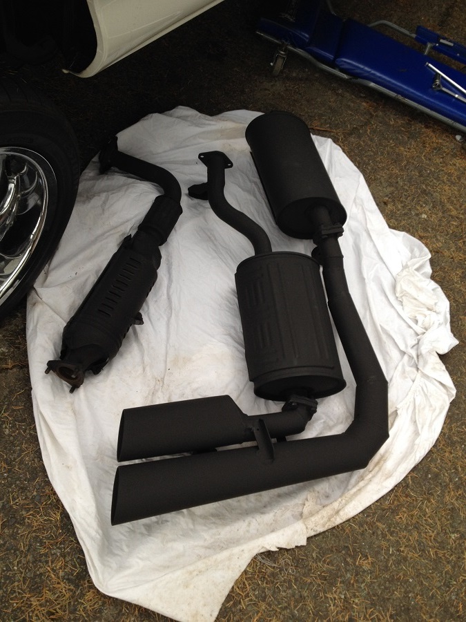

Have not decided on exhaust yet, clearly there are improvements to be had over that looooooonnng 1 3/4" noodle (or whatever diameter it is, it looks puny especially in those tight 90°bends) going all the way out back, but there is something special about how silent this thing actually is. Uber quiet compared to most trucks. Hmmm perhaps dual stockers out the right side, instead of merging into one? Turn the stockers on their sides? even keeping the little silencers or whatever they are? Hmmmm no noise complaints from the fiance would be a bonus, especially since she might actually set foot in this one.
