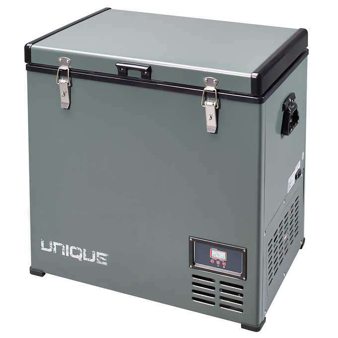

Anyone have any experience with this one? It's from Costco...The price seems a little better than some other fridge/freezer combos... Plus costco has a great return policy for if there's something I don't like..
https://www.costco.ca/Unique-2.8-cu.ft- ... 70876.html
