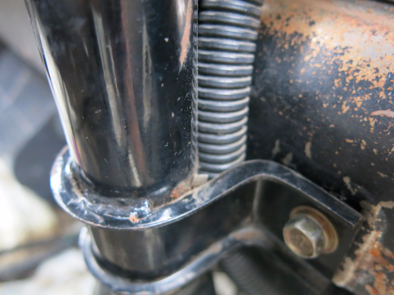

I did read the thread; however it stops at the point I got to because the disconnected wiring connector that attached to the loom below the dashboard would not pass through this space
Falco goes into great detail about refurbishing the existing switch (without fully removing it I take it), but I couldn't gather how to just switch for a second combi switch.
Electrical Gremlins!
Fair enough. Mine's routed around that bracket rather than trapped by it: it's probably something I changed so long ago that I've forgotten about doing it.
