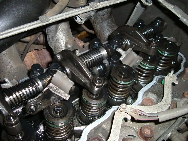

I strongly recommend to all customers to replace the timing/balance belts and tensioners when importing a Delica . It is not always the belts that fail , the tensioner pulleys are most often the cause of belt failure . Mainly the balance belt tensioner falls apart throws the debris around causing the timing belt to fail . Belts , tensioners = peace of mind !!!
This is what happens without peace of mind !!!
