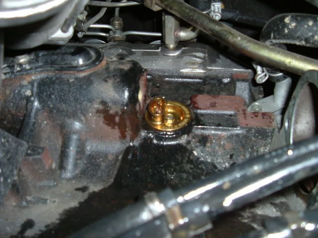

I have been asked many times about preference of block heaters . I have found better heating and reliability in "block heaters" instead of magnetic or in-line . Most people are unaware of the availability of block heaters but they are out there and work very well . They are installed in the core plug behind the starter motor on the drivers underside of the engine . This picture is taken from under the vehicle looking up with the starter motor removed .

Where are they available? I looked into a block heater but with no luck. I have opted for an oil pan heater at this point, something my mechanic told me was better suited for the diesel anyways. Your thoughts?

Hey this is good news. I was under the impression that installing a block heater was very complicated and not worth it. Can you tell us what size block heaters we need for our vans? I'm going to do this to my van as I like the idea of a block heater over the oil pan heater or the in-line heater.

This is good news. How much is it to have a block heater installed? Not sure that I'd need one here, but I was thinking it would help make the switch over from diesel to veggie oil faster in the winter.

It took many attempts to find the correct block heater to fit but they are Temro 310-0051 or Napa 605-3509 . I have nearly forty in stock and they sell for $49.15 each . It takes about two hours to install so $230.88 installed inc.tax
