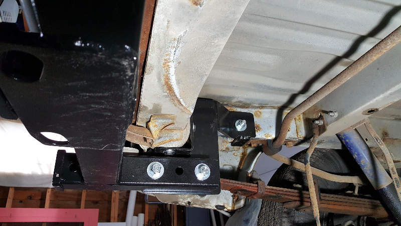

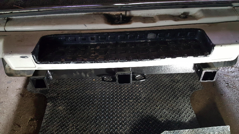

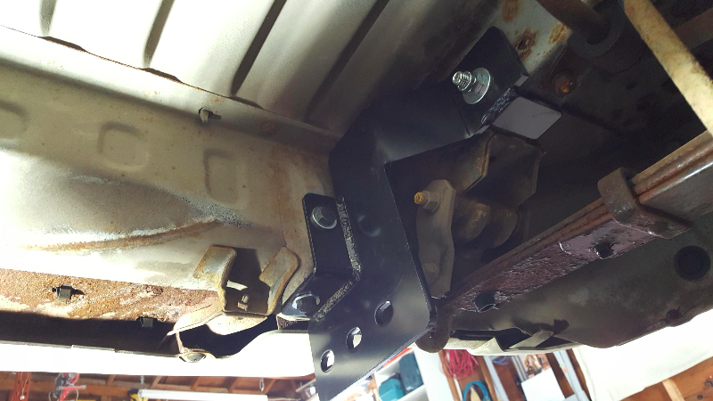

I've wanted to put a receiver on my delica for a while. For towing a trailer or bike racks etc.. Finally got around to ordering a kit from Steven @ Rising Sun Imports, and to be honest, it was one of the easiest installs I've done. I spent hours on the phone here in Edmonton trying to get a shop to weld something up or modify a receiver for the 1992 Delica, but nobody wanted to touch it. Getting the kit from Stephen was super easy, and very happy with the result! :-D Uses 3 existing bolt holes.
NOTE: I actually had to move the bolts to the first 2 settings on the large middle part to make a little more room for when I lifted up the spare tire.... in the pic shown it has the bolts in the 1 and 3 holes..

I have the very same one: installation was flawless. It is very well made and strong ! My bike carrier goes there too :)

It is a Very good quality part, easy to install. The only drawback is that any oversized tire, even with the stock rim/wheel, will make the spare tire holder not to fits perfectly into its original position.

I believe I ran into the same issue. I just had to drill a hole a bit lower for the tire mount, so the tire would fit under. Might need a different fix for a larger tire.
