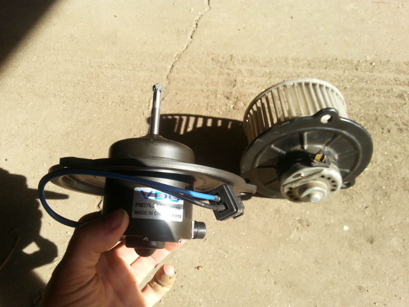

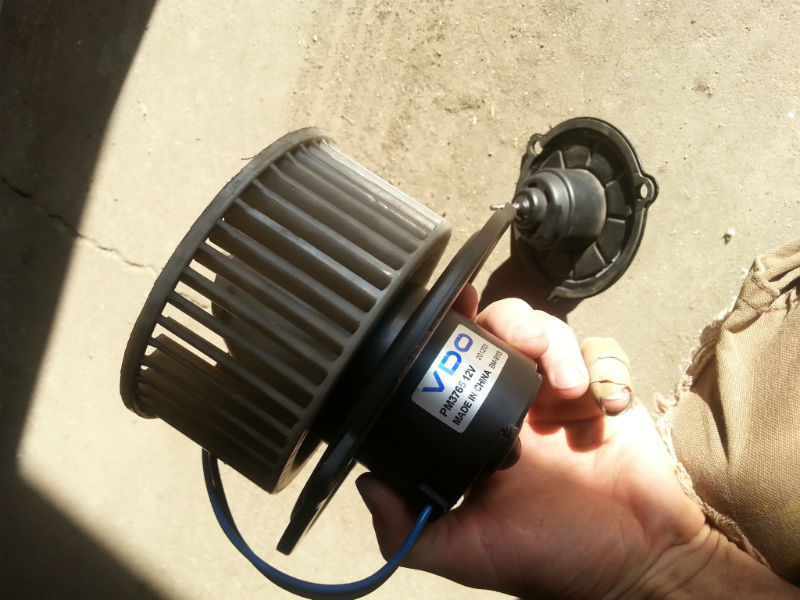

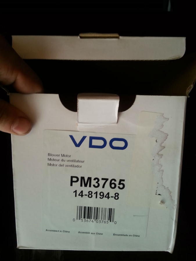

So my front heater motor started acting up a last year... I did the kick test to get it going.. worked for a bit, but in the long run I had to replace it.
Was able to get a replacement motor, just had to swap out the plastic blade piece that fits on the motor. Hardest part is getting it out, not too much room under the dash with the cooler box. Ended working out great. And I believe that it's the same motor for the rear heater also. Thought it might be useful info for someone else on the board. =)
