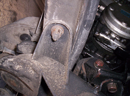

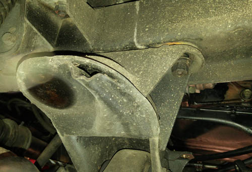

The classic L300 Clunk is most commonly caused by two things:
-Subframe nuts. The front suspension wishbones are mounted to two subframes. The 17mm nuts holding the rear subframe to the chassis rail often come loose. They should be ridiculously tight. Also check the front subframe bolts while you're there, though they're usually ok.
-Anti-roll bar bushes.
Bad:
No Bushings.JPG (70.28 KiB) Viewed 2975 times
Good:

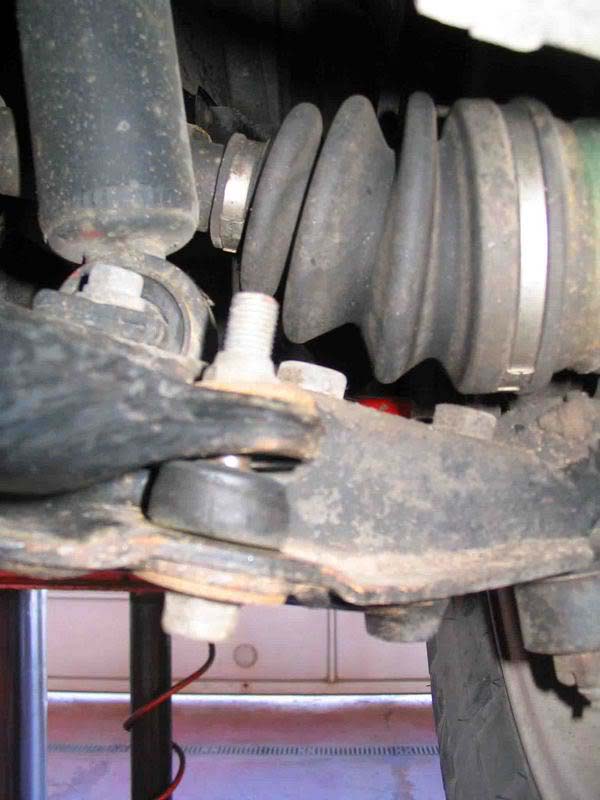

Other things to check while you're under there are:
-Top and bottom ball joints
-Steering tie rod end joints
-driveshaft play (pull and push on the CV joint, it shouldn't move in and out very far)
-Shock absorber lower bushing
-Lower and upper wishbone bushes
-Brake caliper mounting bolts
-undertray/splash guard mounting bolts.
