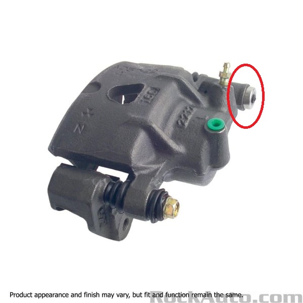

On a side note, is the caliper slide pin with the metal cap over it meant to be lubed. Why the cap on one but not the other. See attached picture.

Any thoughts on the upper slide pin cap circled in red?

The cap on the slide pin is just a dust cap. Both sliding pins should be greased with brake grease. The workshop manual says "rebuild kit grease (orange)" so that's no help.
The other pin doesn't have dust cap because you need to be able to remove the bolt to change the brake pads. Remove bolt, pivot caliper up on the top sliding pin.
