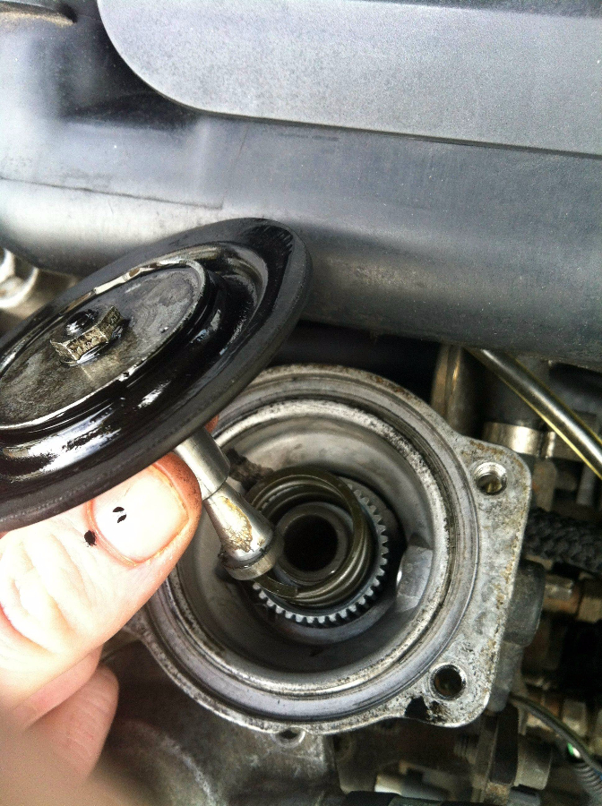

If you still have smoke while accelerating hard, consider winding the boost compensator spring seat up on the injection pump. Remove the diaphragm cover, mark the diaphragm so you can replace it in the same orientation, and then wind the starwheel up (anticlockwise as viewed from above) a couple of turns. (mark the starwheel too, and write down how far you turned it so you can put it back later)
That will reduce the amount of fuel injected when the turbo is on boost. It'll also make the engine slower, so don't go drag racing until you get the hang of your new engine.
