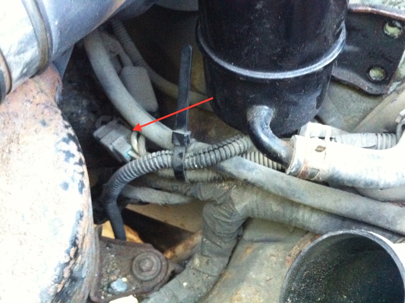

Thanks I'll try your suggestions Growler. I think it may be attributed to this connector being all corroded as well. I feel like it is for the temp gauge, could be wrong though! One wire was actually apart from corrosion but after splicing it together still isn't registering.

north54 wrote:Thanks I'll try your suggestions Growler. I think it may be attributed to this connector being all corroded as well. I feel like it is for the temp gauge, could be wrong though! One wire was actually apart from corrosion but after splicing it together still isn't registering.
SCRATCH THAT, I can learn a lot from reading a schematic!. Thats not the right connector. I'll check the one above the injection pump.
