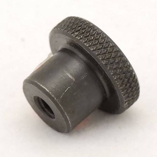

Man I didn't realize the throttle adjust was that simple! Definitely going to build my own now!
Might use one of these instead of the wing nut though...
