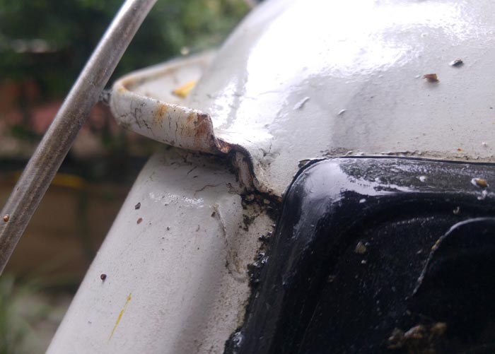

The rain gutter is a potential but I'm still not sure where people are sealing these? If I put a glob of silicone in front of the gutter wouldnt that block the water from draining out of the gutter? Is that the point?
The right hand side (the side that's really leaking) has the trim and a little black cap but i couldnt see how that would stop water. Was there another cap besides the one on the trim? My left side has no trim or cap and doesn't leak onto the floor.

The gutter is really just an external flange so they had some place to weld the roof panel to the A-pillar and cant rail. Where the gutter ends in the corner of the windscreen all those panels come together and are sealed with seam sealer. The sealer eventually dries out and cracks (I can see some cracks in the sealer in your gutter) and water wicks its way into the pillar.

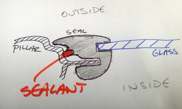

I see in your photo that the rubber windscreen seal already has some kind of sealant under it in the top corner. You may need to add more sealant further down the pillar.
The correct way to fix it would be to remove the windscreen, clean the windscreen aperture, dig out the dried up sealant in the A-pillar area (including under the gutter where the A-pillar meets it, and along the top of the gutter for about 6" back), re-seal it with polyurethane sealant, and paint it. While the windscreen is out I'd also re-seal the lower corner joins and the troublesome seam behind the removable corner panels.
Once the paint is dry, clean all the old sealant off the windscreen rubber (rags and turpentine should work) and reinstall the glass, using a bead of non-hardening mastic style windscreen sealant between the two rubber flaps. The windscreen seal is designed to allow water to escape, putting sealant anywhere else can trap water behind the seal. Ask me how I know this... :-(
If I wasn't removing the windscreen I would dig out as much seam sealer as I could, clean any sealer from under the windscreen rubber with rags and turpentine, re-seal the body seams with polyurethane, wait for it to set, then squirt some non-hardening windscreen sealant under the rubber seal all the way across the top of the seal and down the pillars.
Avoid silicone sealants, as they will interfere with adhesion of any paint or filler in future.

I thought it was weird the paint was cracking like that within the gutter. Didn’t know there was sealant under the paint.
I put the sealer under the corner of the windscreen gasket but not the entire window gasket. Will try that too.

I had this same exact issue and racked my brain for the longest time until I noticed the separation at the gutter. A couple of applications of silicone solved it immediately.

I cleaned up the gutter area and put sealant where the cracks were. Now there’s no rain in sight. We’ll see if it works next time it rains. I’ve already pulled the carpet back to let it dry out. No rust at all under there.
