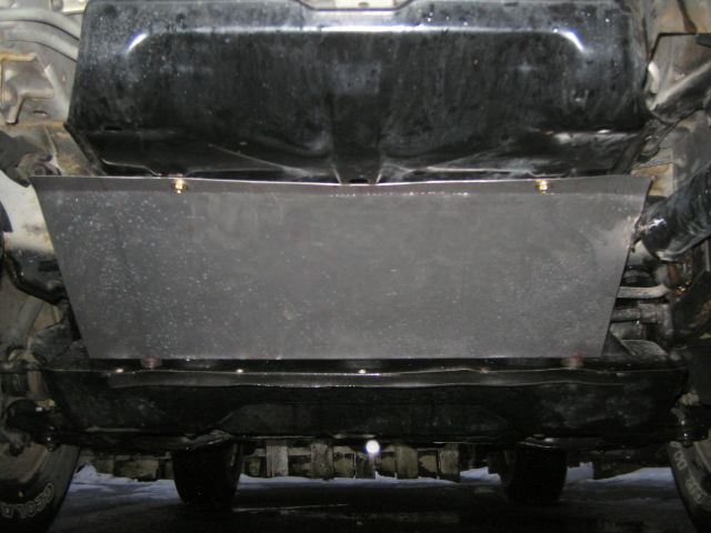

As mentioned in another post;
"I've installed a windblock on my vehicle. I got a piece of thin gauge sheet metal at Home Depot (it was actually the exact measurement I needed, so no cutting req.) did some strategic bending, drilled 4 holes and one cut to fit around a frame member, and "PRESTO!" A wind block. I goes right up front above the skid pan. It blocks direct air from being forced up to the rads, and eventually into the cab, cause the 300's are draftie. It goes on in the fall when temps hit the low teens."
I recently discovered (while driving) that a blanket laid out across the back of the front seats helps keep the draft away.
- IMG_5366.jpg (47.53 KiB) Viewed 5444 times
