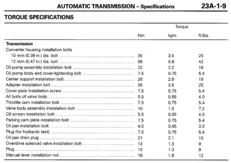

Or at least not one I trust... this is all I can find in the manual, but the torques for the 10mm seem way high to me (50nm/35ftlbs).
Screen Shot 2018-10-24 at 10.13.34 AM.png (18.3 KiB) Viewed 4348 times
Weird thing is, I suddenly developed a transmission seep/leak at the back of the pan... and when I checked the bolts they were all very loose, not much more than finger tight. Could a fluid change cause the gasket to soften? (I did not drop the pan)

I think those torques are for a 10mm diameter bolt, not a bolt that needs a 10mm socket...which would be a 5mm or 6mm bolt

"Engine and transmission tightening bolt" should be "engine *to* transmission bolts"- the ones on the bellhousing.
Oil pan is 4.5Nm/3.3ft.lb
(From the full workshop manual, which has a more comprehensive section on automatic transmissions. http://www.delica.ca/forum/viewtopic.php?f=17&t=17809)

I went through every section of the manual where I thought it might be but I never found section 23A... still can't find it...
