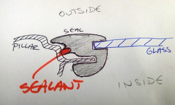

For the windscreen you want a non-hardening sealant, applied as a bead between the two inner flaps of the seal before installation, so it ends up like so:
The seal is designed to drain water away, if you put sealant anywhere else it can clog up the drainage channels and just make the issue worse.
