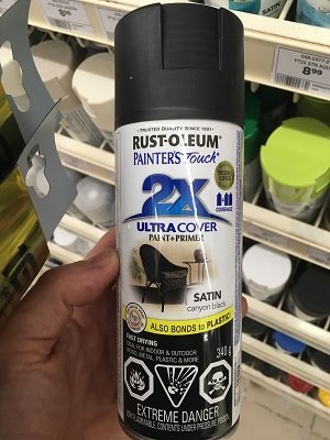

I saw this stuff at Canadian Tire. And i did some research on how to paint plastic. Seems reasonably straight forward. Now I just have to figure out how to remove the plastic along with the rest of the bull bar..... lol
