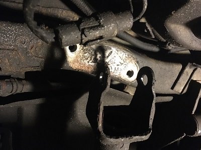

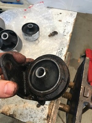

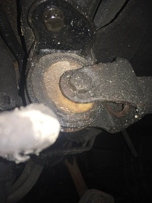

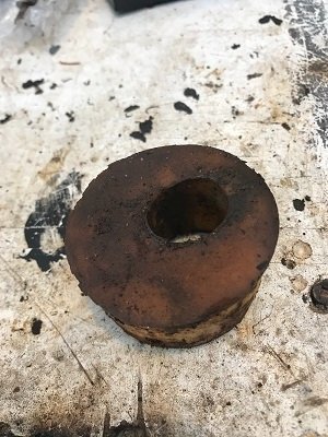

So these are the transmission mount bushings:

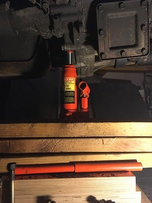

I placed a jack under the transmission to take the weight off the bushings
and removed them. They came out fairly easily.

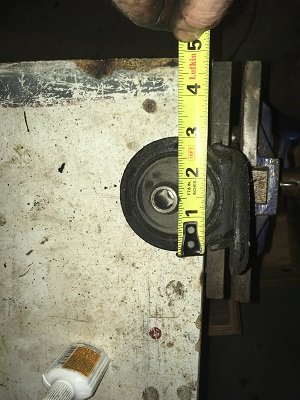

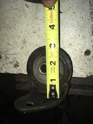

I measured the position of the sleeves as they are not centered in the bushings.
Last edited by deskinthewoods on Wed Jan 01, 2020 2:33 pm, edited 1 time in total.

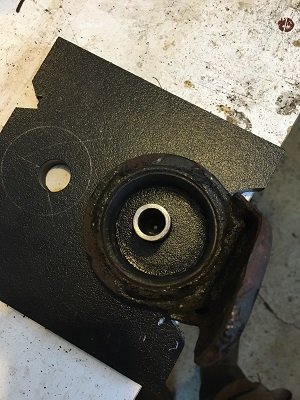

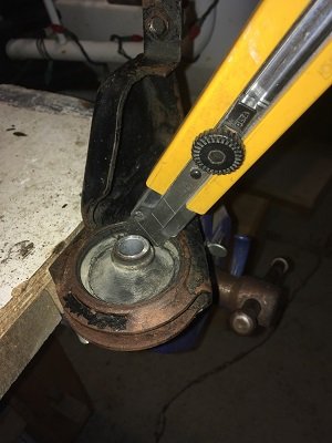

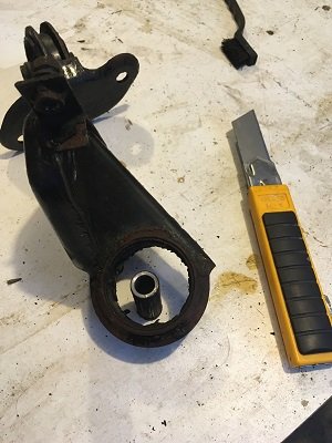

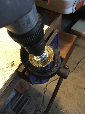

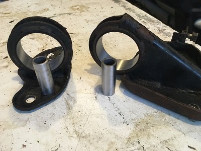

I cut out as much of the old rubber as possible with a utility knife
and cleaned up the rest with a wire wheel in a drill. The bushings have an outer metal ring around the rubber that can be pressed out of the housing but I left it in in case this all goes south and then I can press out the whole mess. It only took about a half hour to remove the rubber and clean it up.

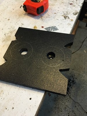

I made up a couple of platforms from cutting board plastic (HDPE) as nothing sticks to that stuff. I drilled a hole to hold the metal sleeve, deep enough to have the sleeve centered side to side in the bushing
I put a bead of silicon around the bushing housing and in the sleeve hole and let that set up for an hour

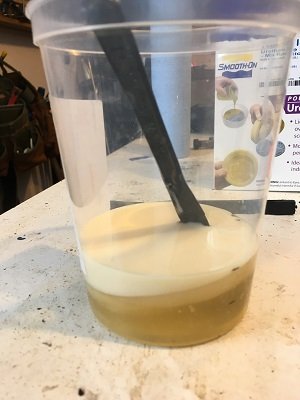

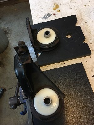

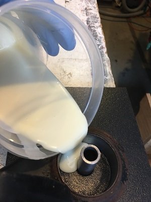

This is the polyurethane product I used. The 2lb kit I got was $30 Canadian. Loads cheaper than the $400 for OEM parts.
It's a simple 1:1 ratio to mix and has a 30 minute potlife.
I leveled up my forms and poured
Now I wait until tomorrow to see how it all worked out. 16 hours to cure....

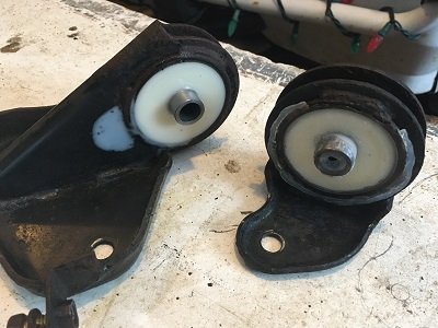

And...SUCCESS!!!
They came off the form easily with just a bit of silicon to clean out of the sleeve
The 60A Shore Scale polyurethane seems to have pretty much the same flex as the original rubber so I don't foresee any issues with more vibration.
And reinstalled

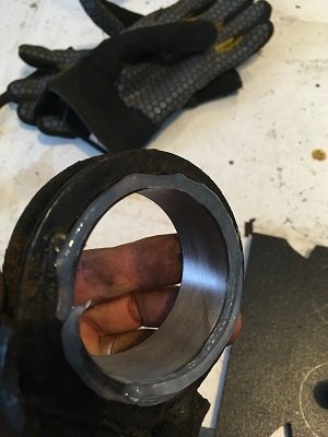

...and a month and half later, they are holding up beautifully...
deskinthewoods
Posts: 240
Joined: Thu Mar 08, 2018 10:35 am
Vehicle: 1991 L300 Star Wagon named "Wilson"
Location: Wakefield, Québec

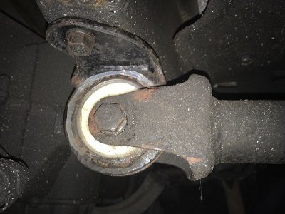

Re: ReCasting Bushings with Polyurethane
Post by deskinthewoods »

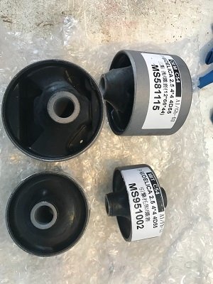

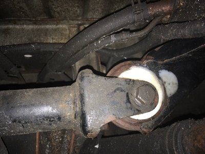

...and after a little over a year, they have worn not great. The polyurethane casting slid right out of the bracket...
I ordered new bushings from https://www.facebook.com/TxTxTWorkshop/ ... e_internal,
where they are very helpful and pretty quick delivery considering they are in Taiwan, under two weeks.
I managed to press the two smaller ones in myself with a vice and a hammer, but the larger two were beyond my capabilities so had my local garage press them in...

I think the poly I used wasn’t stiff enough.
